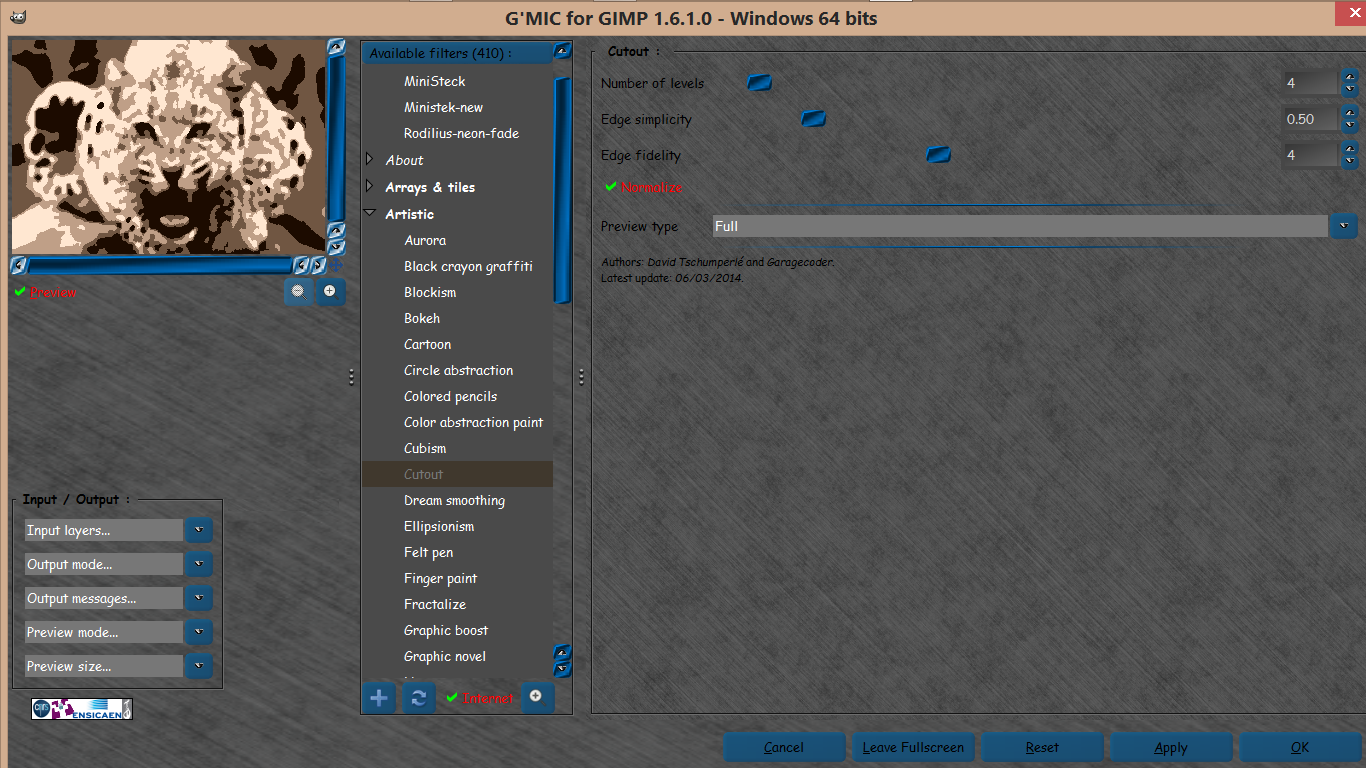

This is how i installed Sams version.
I replaced the curl.exe with Sams i also placed the config file in the _gmic folder allthough that probably isn't needed. And installed (wrote over) all the other files in the user/gimp-2.8/plug-ins folder with the 64 bit dll's and gmic-gimp executable. Everything including Rodilius works nicely in windows 64 bit.
Here is an example of ministek.
Refresh is very, very fast by the way. :)

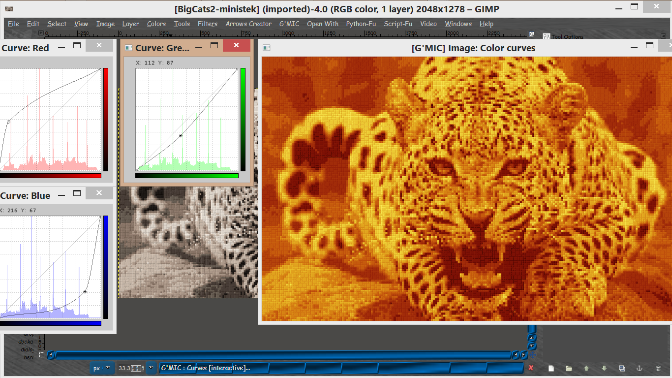

color-curves interactive.Works well in windows 8.2 64 bit also.
PNG
JPG

After removal of the entire _gmic folder and refreshing G'MIC everything refreshes well and still very fast.
Interactive color curves LAB mode - Everything works fine.This is LAB working on a JPG image by the way.
