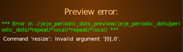

Tried to use today Peiodic Dots, using defaults.
Got this error:
G'MIC 2.9.4 on Gimp 2.10.23 Samj
edit: it happens also on G'MIC 2.9.5pre december

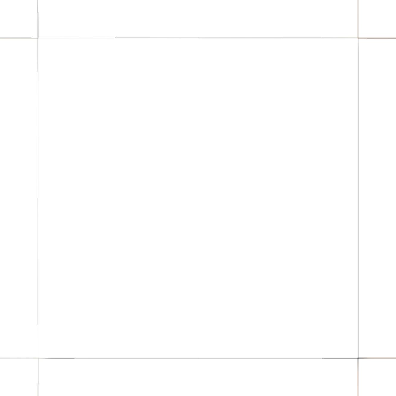

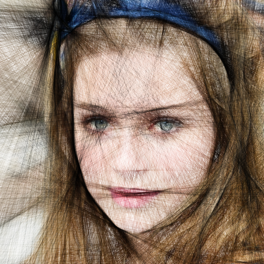

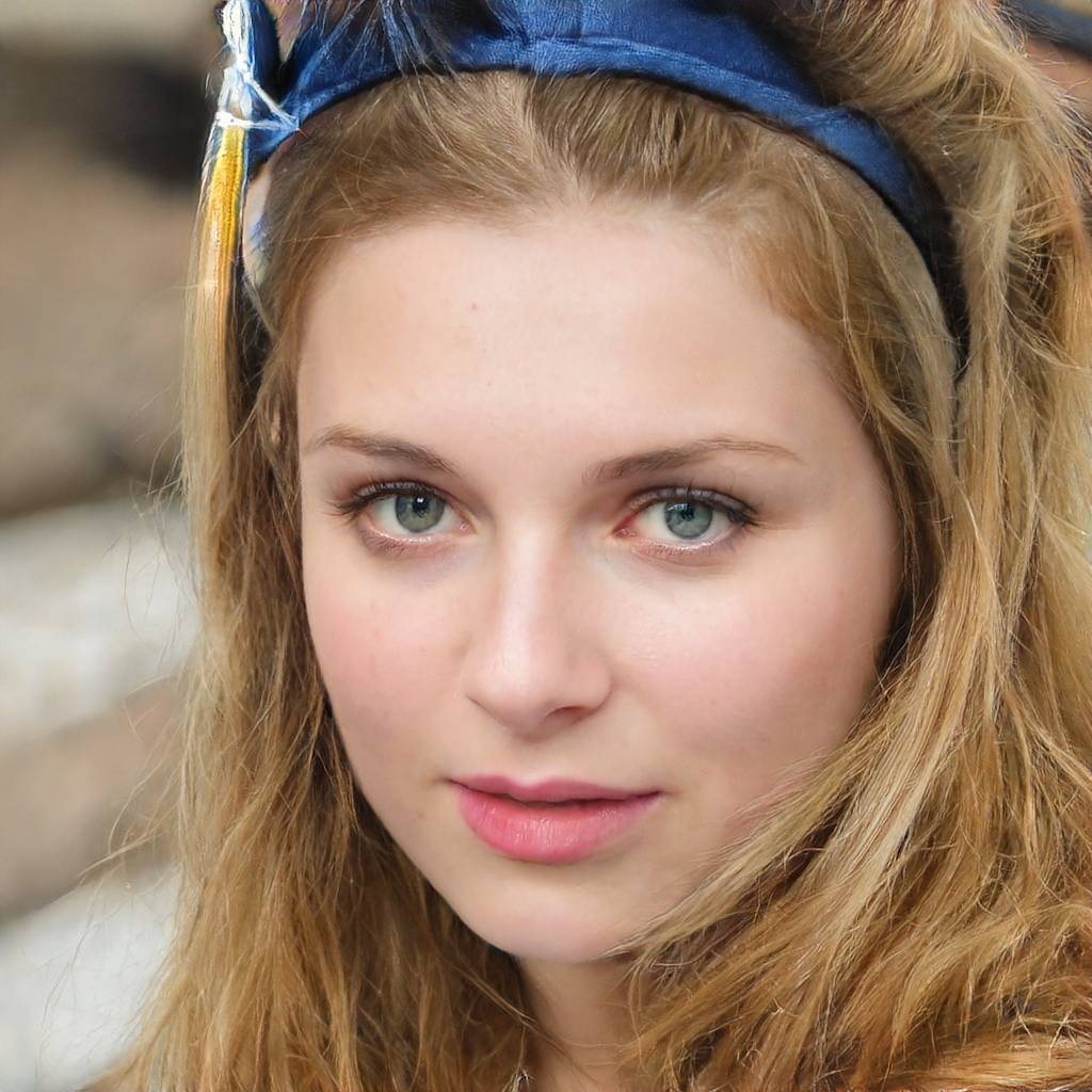

Original image:
Output case A:
avatar-3a679aa338624c8f23b7df7001799a29_unframed_houghsketch.jpg [ 1.65 MiB | Viewed 12430 times ]
Output case B:
avatar-3a679aa338624c8f23b7df7001799a29_framed-blur_houghsketch.jpg [ 47.7 KiB | Viewed 12430 times ]

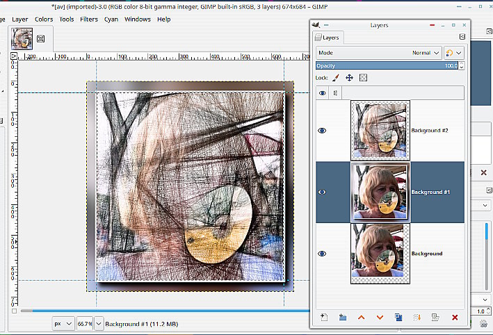

 Post subject: Re: NEW: G'MIC Discussions
PostPosted: Sat May 27, 2023 12:52 pm  (#25)
Posts: 2630
Yep, I can reproduce that as well - kubuntu 20.04 / Gimp 2.10.34 / gmic 3.2.4
A couple of tests. Not alpha. not precision, not multiple layers.
It is the border, isolate with a selection inside the border and Hough Sketch works (although it leaves transparency as a border)
PostPosted: Sat May 27, 2023 1:15 pm  (#26)
Yes, Rich, same solution I did find.
But, isn't it an error? Either in the Frame filter or in the Hough Sketch?
