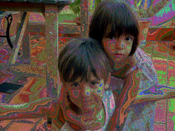

today we talk about a "funny" command:
-uniform_distribution
I call it "funny" because -if I play with the second parameter- I may get funny results.
Certainly they are not funny for a scientist, but we talk among non-scientist gimp users.
Anyhow, to avoid confusion, we will strictly adhere to a basic rule:
because the second parameter is the "spectrum" (which is the name of the fourth
dimension of an image, i.e. the "channels") we will use this second parameter:
a) set to 3 when we play with an RGB image
b) set to 4 when we play with an RGBA image
The first parameter defines the number of colour-levels, which for us become stripes.
First of all we set the environment:
(1)open a new gimp image, white, RGB, default 640x400 pixels
(2)start GMIC console (you know how to) and set output to "new image"
(3)enter this sequence of commands (after having cleaned the area)
(4)-uniform_distribution 64,3 #as in the example on page 34 of the handbook
#this will create an image 64x1x1x3
(5)-normalize[1] 0,255 #as usual
(6)-resize[1] [0] #expand the created image to the gimp image
(7)-keep[1] #to have as output only the new image
case A) RGB image
With the shown parameters we get an image 640x400x1x3 filled with coloured stripes.
You see 64 stripes (=1°parameter), in 4 groups, with colours moving from dark to light.
Each group can be considered subdivided in 4 sub-groups.
Each of the 4 sub-groups contains 4 stripes
The colours vary as such:
(r)the red varies on each stripe with a sequence of 0 - 85 -170 -255
(g)the green varies on each sub-group with a sequence of 0 - 85 -170 -255
(b)the blue varies on each group with a sequence of 0 - 85 -170 -255
case B) RGBA image
(1) modify step 1 to get an RGBA image (use Layer->Transparency->Add alpha channel)
(4) modify step 4 to set the second parameter to 4 (-uniform_distribution 64,4)
You still see 64 stripes, but in 3 groups subdivided in 3 sub-groups.
Each sub-group has 7 stripes, except the first one wich has 8 stripes
(or -maybe- there is an initial group of one stripe only, you cannot distinguish)
The first group(1+7*3 stripes) is totally transparent, because of alpha set to 0.
The second group shows an alpha of 127.
The third group shows an alpha of 255 (full colours).
We will consider the last group for colour analysis (for the other two apply alpha).
In this third group the colours vary as such:
(r)the red varies on each stripe but not with an equal sequence on the sub-groups
(g)the green varies with the sequence 0-0-0-127-127-255 along each sub-stripe
(b)the blue varies regularly among groups with value 0-127-255
Maybe that -having an additional channel- the number of stripes has to different.
What to do?
It's up to you.
I play converting those images to gimp palettes and mapping one of my images with them.
You can see the result.

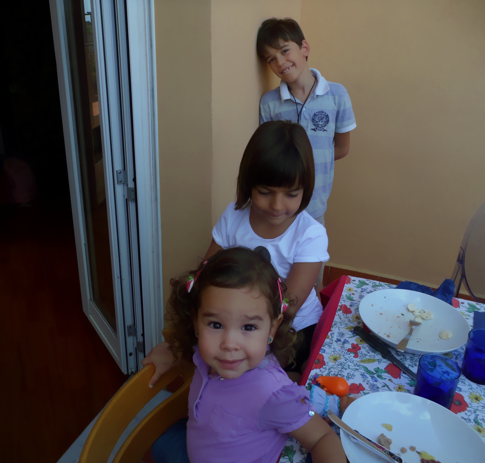

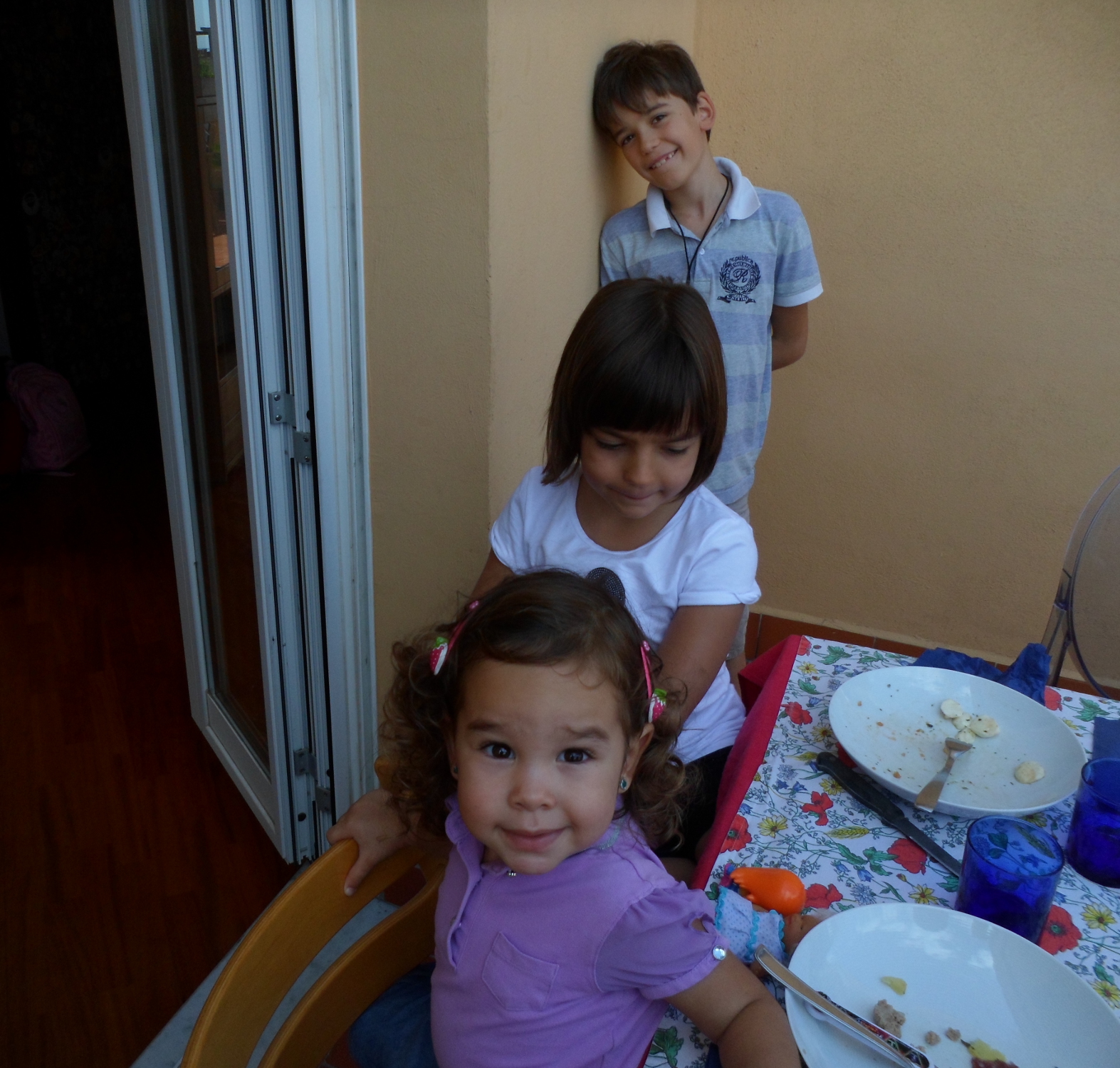

Tip #12
Today we will enter into photo manipulation/enhancement.
At first, a very useful denoising command:
-bilateral
This works better than other "traditional" methods:
- it does not blur the image
- it does not create halos
because it preserves edges (does not average pixels across edges).
Warning: this "quality" may become a "defect" when command is used with high values.
Result could be a "cartoonised" image.
The command uses two parameters:
a) the "space" (extension of the area around each pixel to be used for averaging)
b) the "range" (the minimum amplitude for considering an "edge")
We detail two approaches:
1 - applying the denoising function to each colour channel separately.
(it's known that noise is greater on red and blue channels than on the green one)
2 - applying the denoising function separately on luma and chroma
(it's known that we may blur colours more than luminosity)
Case 1
enter the following sequence of commands:
--split[0] c # the input image is split into 3 layers: R,G,B
# we use the naming command as already learned
-name[1] red
-name[2] green
-name[3] blue
# now we call -bilateral with different values for each colour
-bilateral[red] 2.5,5
-bilateral[green] 1.25,2.5
-bilateral[blue] 3.75,7.5
# small values for green, higher values for red and blue
# now we recombine the 3 layers into a single RGB image
--append[blue,green,red] c
# we give it a name
-name[4] cleaned
# we save only the result, discarding the rest
-keep[cleaned]
The first value can be better entered as a percentage of image space, for example:
--split[0] c
-name[1] red
-name[2] green
-name[3] blue
-bilateral[red] 1%,7
-bilateral[green] 0.25%,3
-bilateral[blue] 1.5%,10
-name[4] cleaned
-keep[cleaned]
Case 2 using YCbCr to split the image (luma-chroma)
-rgb2ycbcr # split the image into 3 layers, 1 for luma, 2 for chroma
--split[0] c
-name[1] luma
-name[2] chromaB
-name[3] chromaR
-bilateral[luma] 1.25,1.25
-bilateral[chromaB] 8.75,8.75
-bilateral[chromaR] 8.75,8.75
# low values for luma, higher values for chroma
--append[luma,chromaB,chromaR] c
-name[4] cleaned
-ycbcr2rgb[cleaned]
-keep[cleaned]
also in this case, we better use percentage as first parameter
-rgb2ycbcr
--split[0] c
-name[1] luma
-name[2] chromaB
-name[3] chromaR
-bilateral[luma] 0.25%,3
-bilateral[chromaB] 3%,10
-bilateral[chromaR] 3%,10
-name[4] cleaned
-ycbcr2rgb[cleaned]
-keep[cleaned]
I place here one example, but you may play with your images and changing values

Tip #13 (with a lot of questions to scientist)
Still on photo manipulation/enhancement, sill on denoising commands.
After a suggestion of GC, I started looking at the command -smooth.
This should be more efficient (certainly more modern and more complex) than -bilateral.
It tries to identify the directions towards which the smoothing has to be applied for best results.
These directions are "visible" as coloured "tensors"
(see the output of the command: -diffusiontensors on the Manual).
I spent hours googling on the subject, but -obviously- almost any found document is full of mathematics. Not for me.
Eventually, I found a document readable/understandable even by me:
it was written by Zonderr (many many thanks!) on flickr, here is the link:
http://gmic.sourceforge.net/tutorials/anisotropic_smoothing_zonder/
So, basically I simply rearrange his sentences, plus some personal tests.
The command has 10 parameters, up to 7 I was able to -more or less- understand the meaning and the use.
For 3 of them not at all, so I put here my first question to the scientists:
- what do DL - DA - PRECISION mean, and -even more relevant question-
- when does a user need to manage them (which is the effect on the image)?
So, let me summarize the 7 I partially understood (thanks to Zonderr):
1 - amplitude: is said to define the "strength" of the command
questions to scientists:
has it to do with the space around the pixel or not? what else?
what does "60" mean? (minimum 0 and maximum 1000?)
2 - sharpness: meaning easy to understand for anyone managing images
values between 0(everything is smoothed, including edges) and 1(nothing is smoothed)
3 - anisotropy: how much is anisotropic methodology applied?
values between 0 and 1 (beware: the methodology is good but creates artifacts, so use low values)
4 - alpha: is the smoothing applied before creating the tensors, to skip small noisy dots
values vetween 0 and 10
5 - sigma: is the smoothing applied after having created the tensors, to avoid too hard edges
values between 0 and 10
6 - interpolation: 0=nearest neighbor, 1=linear, 2=RungeKutte (best, slowest)
7 - use fast approximation: 0=don't use, 1=use (choice depends on how quickly you drink a coffee...)
I cropped the central part of the image used for -bilateral to make some test.
First run was using all default values.
Good result, but too smoothed for my taste (look at the hair, and also at the skin)
Second run with four parameters reduced:
- amplitude to 30
- anisotropy to 0.2
- alpha to 0.3
- sigma to 0.6
Better result, for my taste; so - for myself - I would say:
use small values if the photo is not so bad (from a digital noise viewpoint).
I tried also to use the command on each separated channel, as for -bilateral.
I used my reduced values for red and blue and even more reduced values for green
(10,0.1,0.1,0.3)
Good result, again for my taste.
Attached a zip file.
Now, a final question to the scientist:
there is a command called -diffusiontensors to create the tensors separately,
then use the result for -smooth.
IMHO, because the parameters to be used in -diffusiontensors are part of those
used for -smooth, I do not see benefits in using two commands instead of one.
I also tried and -apparently- I didn't get any difference, if same values where used.
Am I wrong?
tip13.7z [261.62 KiB]
Downloaded 112 times

Tip #13 addendum
(just in case you like the "ready-cooked"...(only last case discussed previously)
#@gimp test denoise smooth: test_denoise_smooth, test_denoise_smooth
test_denoise_smooth:
#this filter makes use of -smooth command to denoise an image
-apply_gamma[0] 0.9 # makes image darker and reduces contrast in the shadows (Iain)
--split[0] c
-name[1] red
-name[2] green
-name[3] blue
-smooth[red] 30,0.7,0.2,0.3,0.6,0.8,30,2,2,0
-smooth[green] 10,0.9,0.1,0.1,0.3,0.8,30,2,2,0
-smooth[blue] 30,0.7,0.2,0.3,0.6,0.8,30,2,2,0
-name[4] cleaned
-apply_gamma[cleaned] {1/0.9} # Reverses the gamma change at the start to give correct brightness.
-keep[cleaned]
enjoy!
