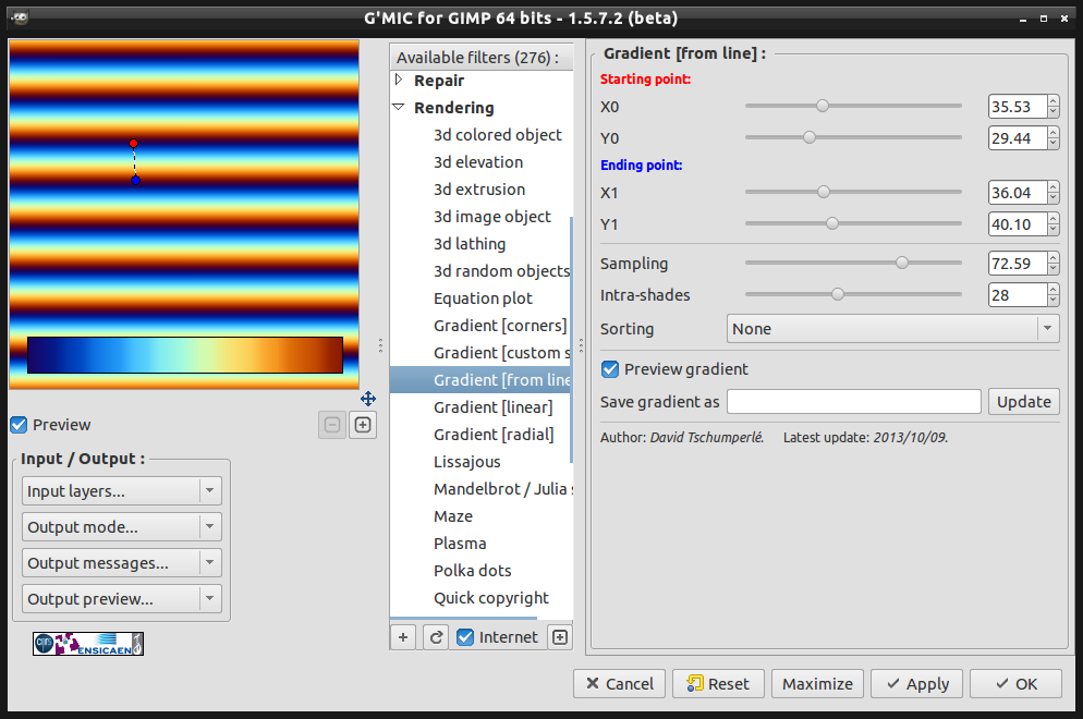

GnuTux : that's weird. I've done a quick test on my side, with the same kind of images as yours. Everything is working as expected.
May I ask which version of G'MIC you are using ?

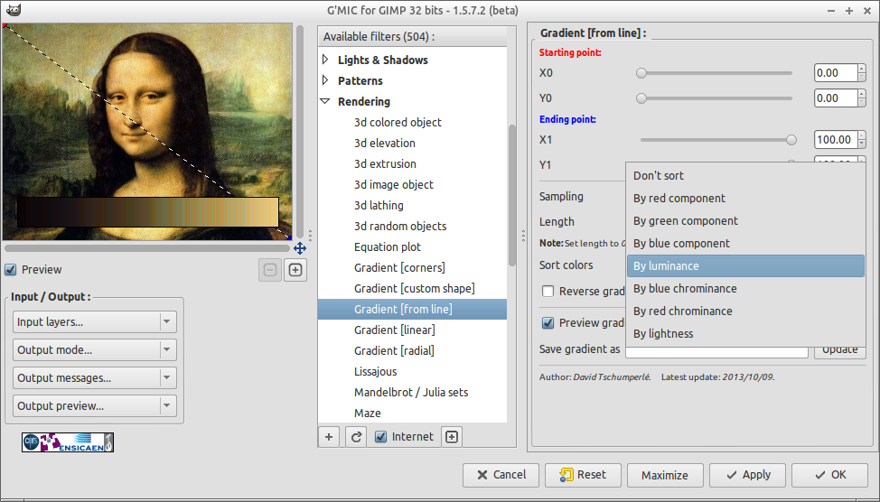

In fact, I've also pushed a new version of the filter, with even more options for sorting the final color gradient :
