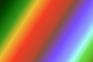

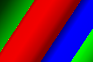

PostPosted: Fri Oct 24, 2014 1:52 am  (#59)
David, I've written a G'MIC filter for "MaxRGB".
It's very very slow, because it performs three times the pixels scan, one for each channel.
If you like so, I can post it here.
an example:
original
G'MIC maxRGB
compared to Gimp maximum RGB
It is just only a "divertissement", because no Gimp-er needs it, being available the much much quicker Gimp filter
Just to let you know that I'm learning from you and Garry...
