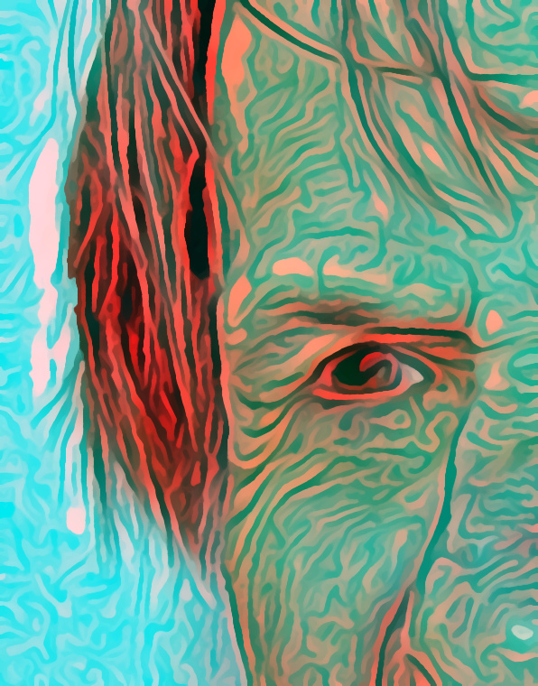

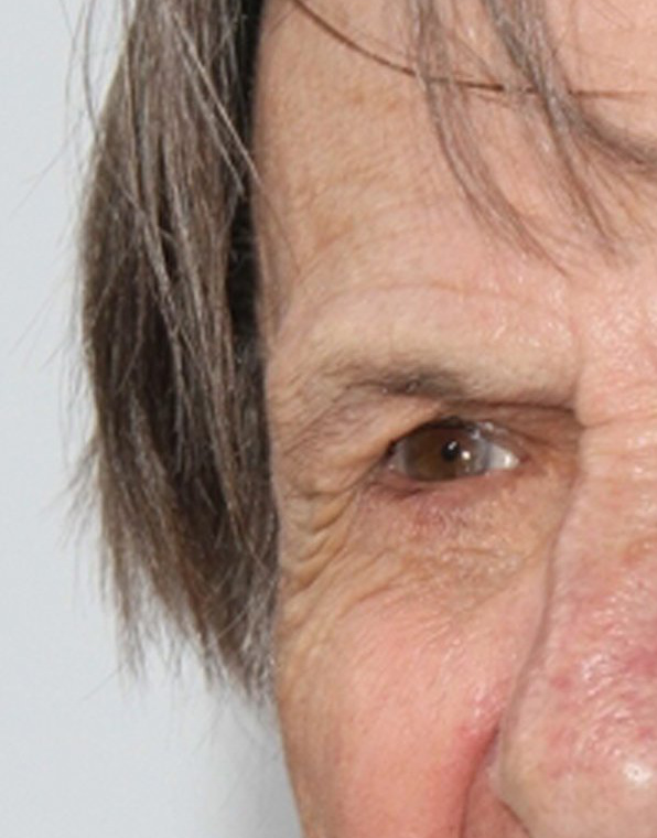

Posts: 12831
Strange color output with G'MIC's Painting preset. Before, at least the colors matched closer to the original, but now getting teal/green like color.

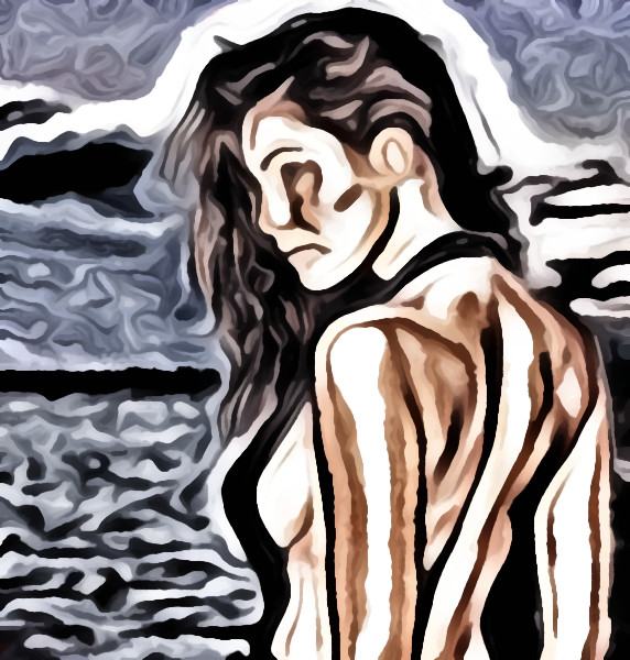

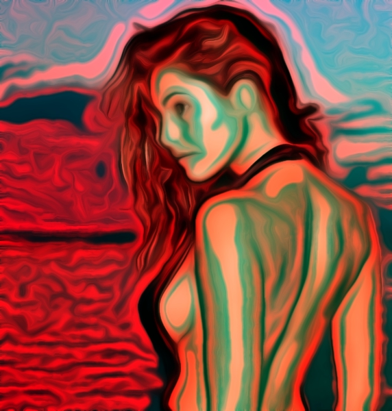

Lyle My Gmic gave same result
Original
Using 1.6.0.4
Using 1.6.1.0

Lyle this is the result from the 32bit 1.6.1.0 (the Irish plot thickens)

Hmmm; wonder if it's one of the compiled dlls associated with 64-bit G'MIC? :)
No, it's happening on Linux too (Ubuntu 14.04 x64, Gimp 2.8.14, GMIC 1.6.1.0 x64).
If you use Gimp Colors>Components>Decompose you'll see that the red channel in the output image looks completely different from the other two ..like the histogram levels are all wrong ..anything lighter than dark grey comes out with max red.

The plot thickens..
After playing around with the Painting preset's parameters, I hit Reset and the output image is okay now. But the preview is still wrong! Still shows lots of red.

The problem extends beyond 1.6.1.0. if you use 1.6.0.4 and refresh filters you will download the same screwed up files

Thanks for reporting, this should be fixed now (after a filter update).
