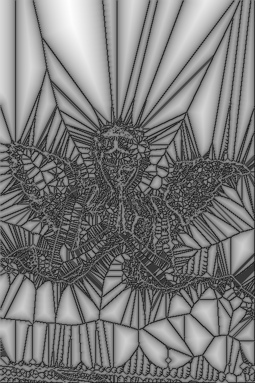

Tip #18 part 6
let's continue
-neq[-1] 0
After having looked at the results, my interpretation of this command is (G'MIC gurus pls check!):
-every pixel of the image is examined
-every totally black pixel stays as it is (0)
-every non totally black pixel (not equal 0) is set to 1
the resulting image -if option "cut" is selected- looks apparently totally black (values 1 do not show easily!); no grey pixels around; but, if we change the option from "cut" to "normalize", we see a B&W image where all pixels not 0 are now white.
So, if we compare the resulting image (normalised) with the image to which ended up the previous post (image2e), we notice much more white (see image2f)
-if $3
-skeleton[-1] 0
-endif
this command is applied if the third (boolean) parameter is set to 1 (yes, true, on...).
Again having looked at the result, my interpretation of this command is (G'MIC gurus pls check!):
- every white area bigger than 1x1 pixel in the picture is reduced to inner lines of 1 pixel ("bones" of a skeleton).
At least this is what appears to me by comparing the outcome with the previous image (see image2g).
But "how" are the "bones" generated? This is a mystery, for me; I tried to do a couple of experiments:
first defining a white star and applying only the -skeleton command; afterwards defining a white circle and applying again only the -skeleton command.
Well, I see the lines ("bones") as being not uniformly generated: look at each of the five points/triangles of the star or at each of the four quarters of the circle: the quarters look uniform among them, but the lines (bones) are not uniform inside a quarter; the points/triangles of the star are not even uniform among them.
So here, it's necessary (for me at least, but also for some of the readers, I guess) to get some nice explanation from a guru.
(continues)
 Post subject: Re: G'MIC - tips and curiosities
PostPosted: Tue Apr 01, 2014 12:45 pm  (#87)
(continued)
-distance[-1] 1
we know already this command, we should get an expected result; here it is: image2h
-watershed[-2] [-1]
watershed is a common word in geography; here it seems to work analogically, in the sense that image2h is taken as a "watershed" profile and is applied to the image we left a few steps ago: image2c; the resulting image can be see here: image2i.
How really the function performs, is a matter for gurus, I hope to get here (again) a nice explanation
-sub[-2] $im
here the original values -modified by the statement "-add $im" during the initial steps- are restored
-normalize[-1] 0,1
well, what we have always seen in the examples, was a "normalised" image, because I adopted the choice "normalize" in the custom code panel; in the command it must be stated explicitely to get a normalised appearance. Therefore, nothing new has to be shown here.
-pow[-1] $2
the default value for the second parameter is 0.2; by using this "power" (less than 1), all pixel values are drastically reduced, but not linearly: big values are reduced much more than small values; if we take this sequence of pixels:
1, 3, 7, 15, 31, 63, 127, 255 the resulting values once applied the power of 0.2 are respectively:
1, 1.24573094, 1.475773162, 1.718771928, 1.987340755, 2.290172049, 2.634879413, 3.029061117;
What does this mean:
1-if we look at the resulting image using option "cut", we get an almost totally black image
2-if we switch to option "normalize", we get a much more luminous image.
I show here the latter (image2j)
-mul
the two images ([-2] and [-1]) are multiplied, so that we get the final (single) image.
Look (on the next post, only 3 images per post): image2k
-endlocal
-done
-verbose +
we know already these statements, nothing new.
We came to the end, eventually!
Hopefully, we learned something on coding G'MIC.
PostPosted: Tue Apr 01, 2014 12:46 pm  (#88)
final image

-neq[-1] 0 - you've about got it. All the boolean commands behave similarly: Apply a test to an input pixel, write the corresponding output pixel 0 (false) or 1 (true) depending on the outcome of the test.
-skeleton[-1] 0 - if you see how -skeleton is put together in gmic_def.gmic, you'll discover that you have seen it already: it is -distance to zero, and the resultant is -sharpened a fantabulous amount. Then there is a new bit: a copy of the skeleton is made and eroded two pixels, and the eroded copy is subtracted from the uneroded copy. In effect, any field of white is replaced with a hairline perimeter.
-watershed[-2] [-1] Yep. Is inspired by water flowing downhill. Watershed takes a marker image and a 'geography' image. Markers indicate where 'liquid' begins flowing and is usually (not necessarily) a set of points. The color of the liquid stems from the color of the marker. The geography image indicates where the hills are, how steep are their slopes; the geography image determines how liquid will flow. Liquid flows until it hits another flow of liquid (a border appears indicating a barrier separating the two catchments) or until it finds a local minimum.
Roughly the midpoint of some catchment. The process stops when liquid has flowed everywhere, leaving no 'dry' (unmarked) pixel.
Markers are also called 'labels.' Recall your 'J&B' remarks some number of posts ago. -watershed furnishes some context for that mysterious comment.
Good to see you over the finish line. I have enjoyed you unfolding the whole sequence.

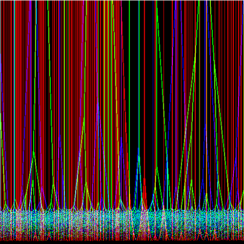

@Garry
my first curiosity
Hi Garry,
I come back to you very soon...don't hit me please!
I had a look (as you suggested) to the code implementing the command -skeleton.
From there I took only the first two lines of code plus the fourth one (omitting blur):
-ge 50%
-distance 0
-sharpen 1e10
and put in the "custom code" panel of Gimp-G'mic.
Then, I just created a square image filled in with a gradient red to black.
(BASE)
Then I run those three lines of code.
As expected, the command -ge 50% cuts the image into two horizontal sections:
the bottom half remains totally black (all those pixels are below the limit of the threshold so none of them is affected by the next commands), the top half is converted into a sequence of many red lines; but they seem to be "drawn" at different horizontal distances among them, and there are also small segments.
Is there a ("simple") understanding of this result for poor users like me?
(GE_50pc)
But, this is not all!
I tried a different test by changing the limit of the threshold to 0.1%; I thought I would have seen
an upper part 99,9% high having lines similar to the previous ones; surprise!
The lines are multicoloured, very nice but totally unexpected by me, and the part closer to the bottom
0.1% black zone has even a kind of coloured sand, like in a sand-glass.
Is there a simple understanding for me?
(GE_0-1pc)
Many thanks in advance.
(note: should I bother you with all these questions, just tell it to me, and I will stop, I can understand you are busy with much more interesting tasks...)
PostPosted: Wed Apr 02, 2014 5:40 pm  (#94)
Joined: Mar 15, 2014
Posts: 115
Location: Brooklyn, NY
-sharpen, as used in -stained_glass, attempts to unblur what has become blurred.
Blurring is like squeezing toothpaste from a tube. Bit treacherous for four year olds, maybe, but they get the hang of it.
Unblurring is like getting the toothpaste back in the tube again.
-sharpen is faced with a task of reconstruction - make sharp again that which has been smeared by blurring. Now, there are all kinds of ways to blur an image. What is more, there are even some ways to unblur an image, but such ways usually depend on knowing what the original blurring method was and also knowing that this method was not destructive. Usually, though, when an image comes from out of the blue, and blurred, we have no idea what mechanism blurred it or whether it was destructive.
So we punt.
-sharpen is a tool with which we punt.
-sharpen embodies two unblurring technique. One is called shock filters, which we haven't been using, the other is called inverse diffusion, which we have.
Inverse diffusion is an interesting technique grounded on the analogy that a warm room with a hot rock used to be a cold room with a red hot rock - but that heat has diffused out, cooling the rock but warming the room.
-sharpen assumes that the sort of white areas in an image were once very white, the sort of dark areas were once very dark, and by implementing a process of inverse diffusion - pushing the hot back to the hot spots and the cold back to the cold - that maybe it can reconstruct the sharp transition edges that used to be betwixt the two.
Like I said, pushing toothpaste back into the tube.
-sharpen does a pretty good job, considering what it is given to go on, which usually isn't much. The amplitude we give -sharpen controls its diligence. Low amplitude means "Awww - just get the main edges and don't sweat the details." -sharpen won't sweat the details. High amplitude means "Don't come back here until you've found ALL the edges, and - I - *DO* - mean - ALL of the edges!!!!" -sharpen will sweat the details.
Even those that aren't there.
OK. That's -sharpen. Plus a little bit on how to make it manic-depressive.
surprise!
Now there's -distance, which also has to sometimes do two impossibilities before breakfast. -distance has to find the Euclidean distance of a pixel from the nearest reference pixel endowed with a particular intensity level - usually one or zero.
Seems straightforward. In fact, that's the first impossibility.
Euclidean distances are found with Pythagoreas' Formula: the beast which rubbed the ancient Greek noses into the smelly business of incommensurability. That there are numbers which cannot be represented as integral ratios sounded the death knell of arithmos - the echoes of which still sound in the English language today: rational. Nice sane ratios of integers. In terms of computer store, they take only what they need. How polite. Irrational - darn crazy numbers like the square root of two which cannot be precisely expressed unless one has an infinite store of memory handy. So, as often as not, -distance paints intensities which aren't quite right, because it has maybe sixty four, maybe one hundred twenty eight bits of storage, which can never be enough for the idiotic irrationals. That's the first impossibility. The second impossibility is that the distance, so figured or mis-figured, is for a point, dimensionless, infinity small, but a pixel has area and dimensions, so exactly to what does the distance refer? The middle of the pixel? One of the corners? No matter how you call it, the distance is going to be slightly not right for all but one point in the pixel, and it is probably not right for that either.
But -distance is a trooper. As best as it can, it paints a gradient of grays that (more or less) approximate how far pixels are from the benchmarks, suffused through the work, however, is an error pattern.
Now, along comes -sharpen (remember -sharpen?), to which Ronounours has handed an amplitude parameter of 1e10, for cat's sake, 10,000,000,000, alas, and not 27.128, and it's desperately insane about finding edges. Even ones that aren't there. -sharpen latches onto the diffuse error pattern that -distance has dribbled throughout the gradient and exclaims "Hell-on, these are edges or I'm not Harry!" and proceeds to sharpen them out as only a sharpener beset with an amplitude of 10,000,000,000 can. And that, dear dinasset, is what you are looking at - a faint error pattern left by -distance, which -sharpen has pulled from the murk.
And - as an aside - there is a certain sweetness to the thought that what is a bit of annoyance in the realm of computation can be a thing of beauty in artistic hands. So we don't have arithmos -- we never, ever, really had arithmos -- but there are compensations. Just need to know where to look for them.
Hope this helps.
Garry

1-I just wanted to know why the resulting lines were not uniform, as I was expecting
2-I read about the complexity of the used functions
3-I know that mathematics "is not an opinion" (as we say here in Italy)
4-thus, whatever the complexity of the function, with same input I must get same result
5-I tought to have a uniform input, with each pixel varying down from red to black uniformly
6-I wanted to verify this assumption
7-MY ASSUMPTION WAS WRONG! filling a big area with a gradient in Gimp is not leading to a set of uniformely distributed values (at least using my hand)
8-thus, I prepared an area large only ONE pixel (still with a height of 500 pixels)
9-I filled it with the gradient red to black
10-I scaled the image to 500x500
11-NOW I had a uniformely gradient area!
12-I performed again the test and I got .... a gradient area also as a result, without any line.
13-which is also correct for my low-level mathematical mind: THERE WERE NO EDGES TO DETECT!
So, your detailed info was helping myself in going deeper into my thoughts, thanks a lot!
