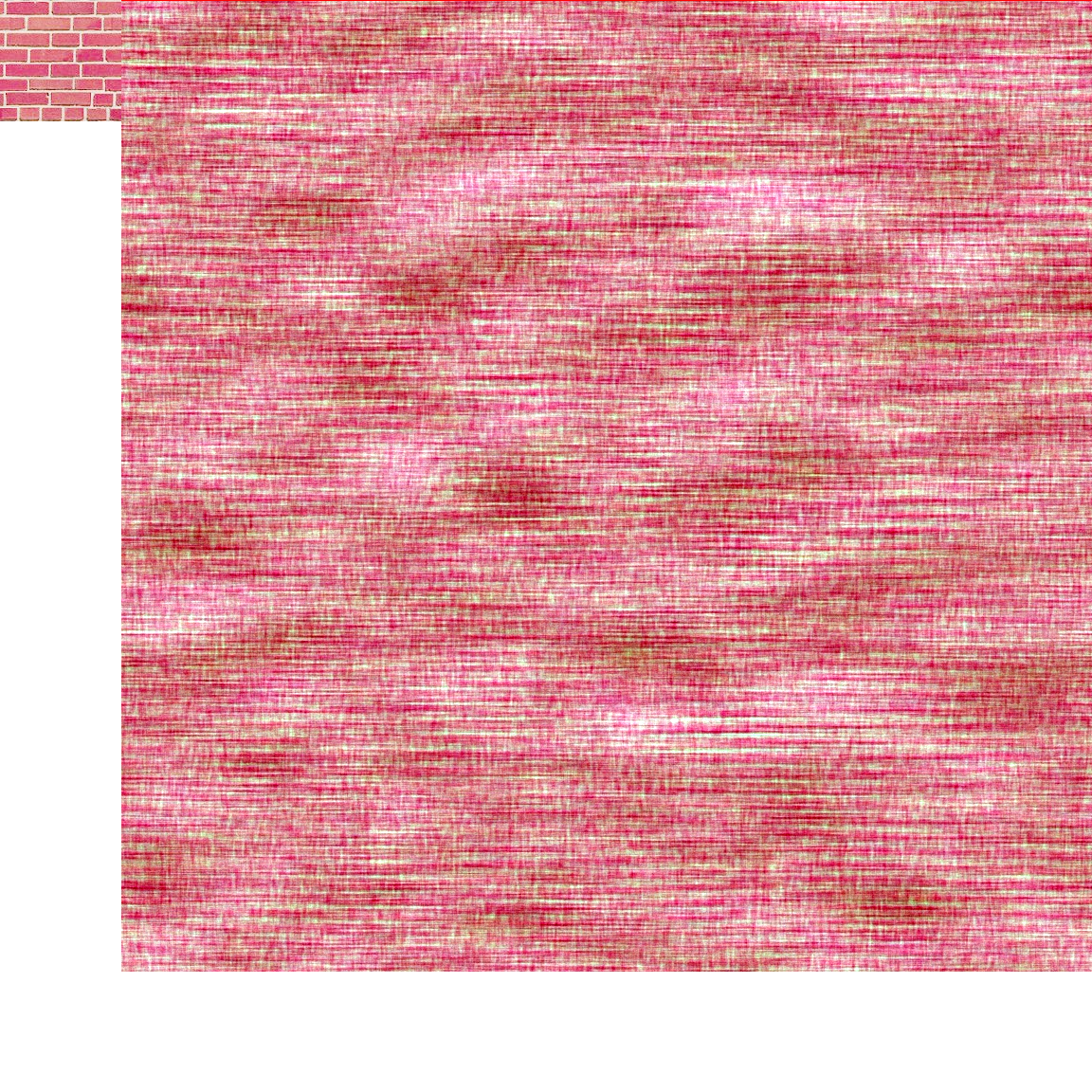

I did some trials, but I did not get what expected.
I mean, looking at your examples, it seems the original texture is almost kept, while in my tests it's very distorted.
What did I wrong?
starting size is 128x128, resulting (default) 1024x1024
thanks

Ronounours wrote:
Note that it works quite well with micro-textures, but definitely not with macro-textures. You have been warned :)
dinasset, please provide only micro textures, which means textures with fine grain and no complex patterns (brick walls e.g are complex patterns).
It won't work at all with macro textures. All the textures you provided can be considered as macro-textures.

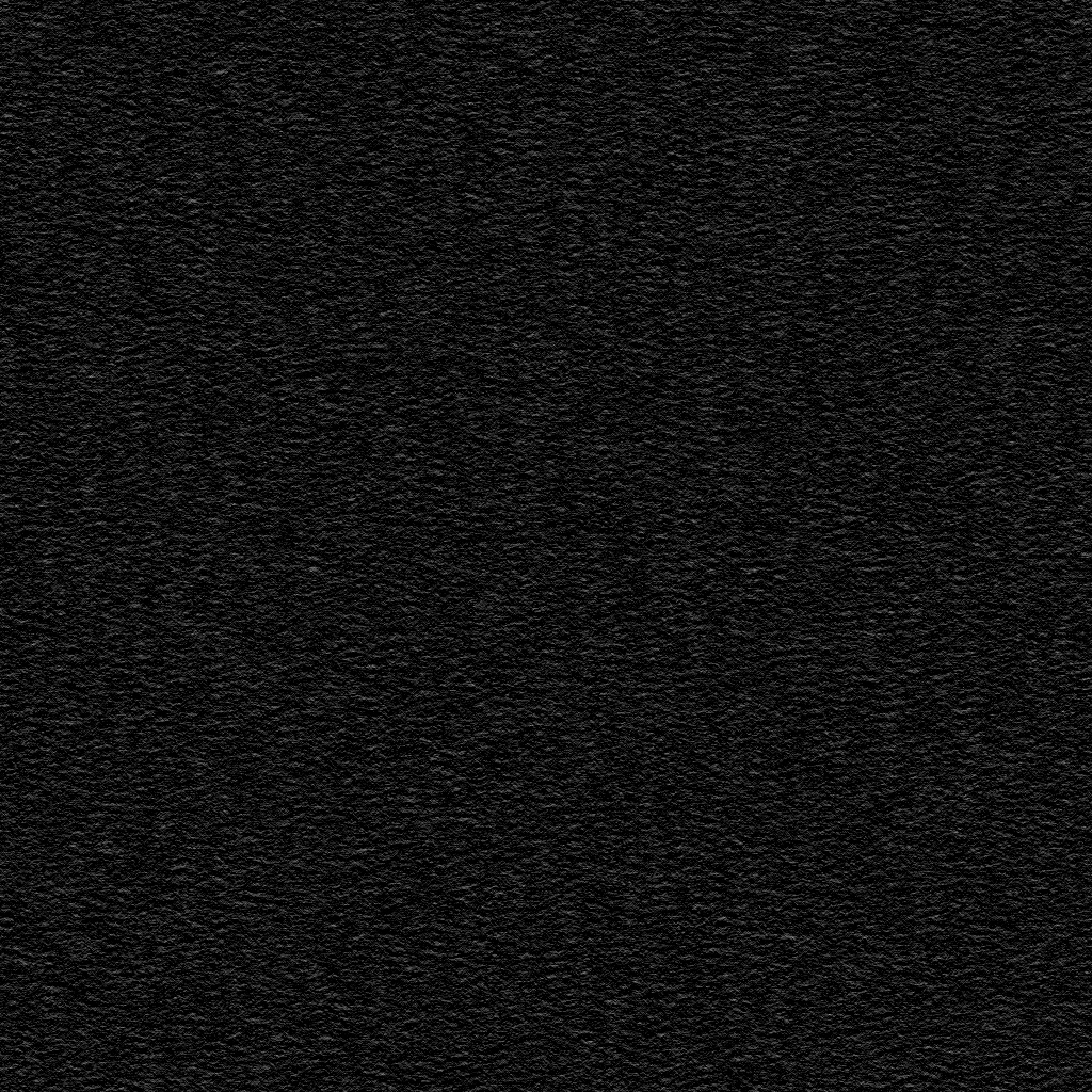

OK David; still, I do see some cool use for certain types of textures so do appreciate it. Just created this black leather texture from a single lego block. :)
