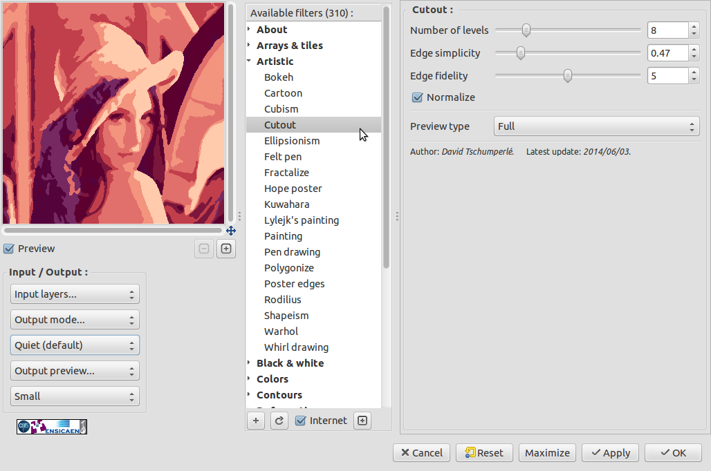

Something like this ?
Maybe, try to refresh your filters!

The Edge fidelity parameter already tells about the amount of edge smoothing.
Transparency problem should be fixed now.
