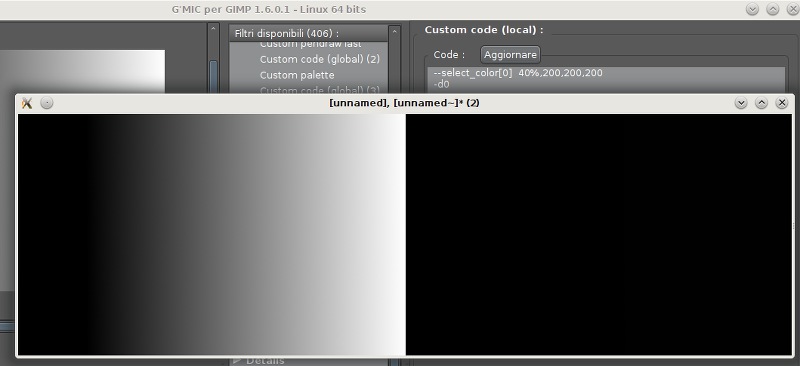

Some bugs?

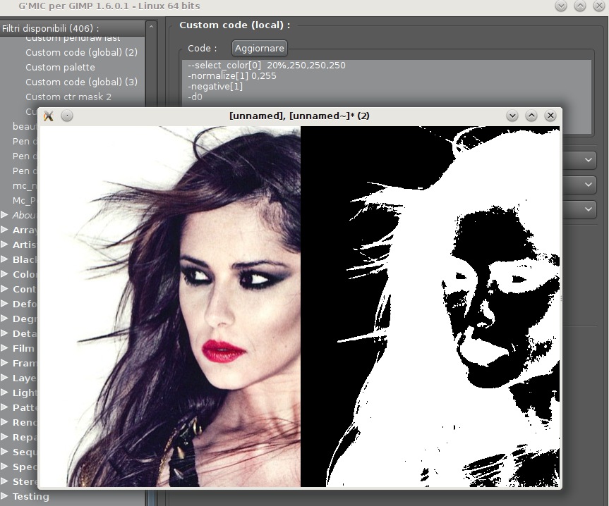

Ok, found the solution.
Now how to use the mask [1] to apply a command/filter to [0] only in white [1] areas?
I search "mask" "alpha" in reference.shtml but nothing help me ...
Thank's.
 Post subject: Re: G'MIC command like "gimp-by-color-select" ?
PostPosted: Mon Oct 13, 2014 2:23 pm  (#6)
Joined: Jan 03, 2011
Posts: 1656
The general idea to do that, is to apply the effect on the whole image, then copy only the masked part of the result to the initial image [0].
Example, with a blur, you can add this to your G'MIC command to do the trick.
--blur[0] 10 -j[0] [-1],0,0,0,0,1,[1] -rm[-1]

I found this solution that seems to work
--select_color[0]  20%,250,250,250
-normalize[1] 0,255
-negative[1]
--append[0,1] c
#-drgba
-b[2] 16
--blend[0,2] alpha,1
-remove_opacity[3]
-d0

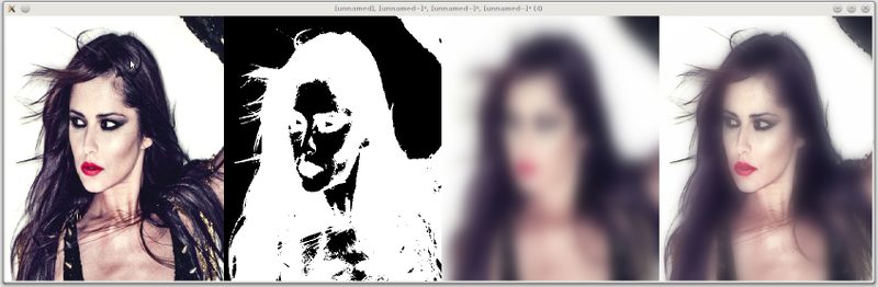

with -image command,
not exactly the same result ....
PostPosted: Tue Oct 14, 2014 7:06 am  (#9)
Posts: 1656
Because in that case, you don't have to normalize the mask image in [0,255].
The values can be left in [0,1].

Same result, but with fewer steps needed:

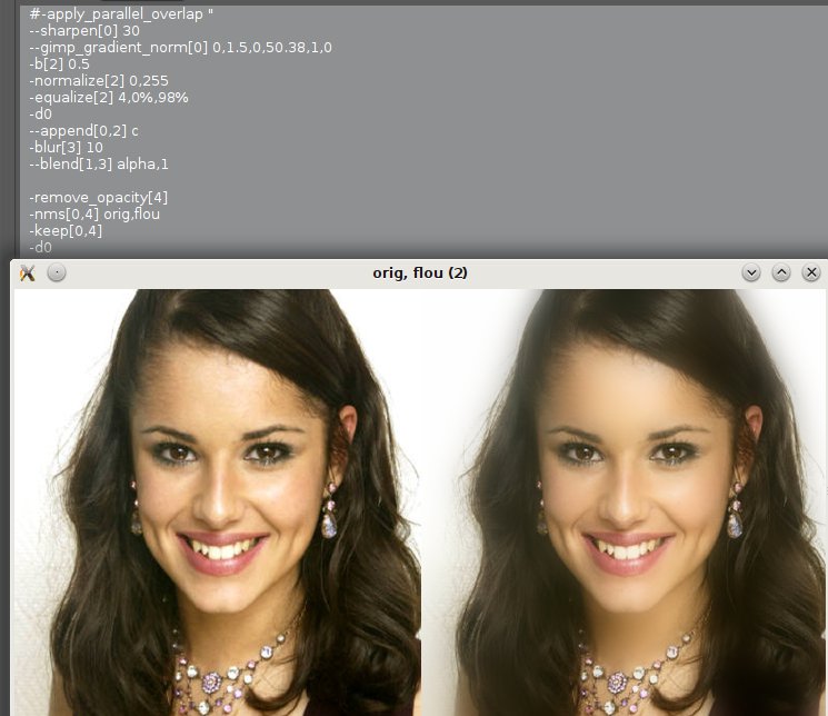

I did some test,
a flou/soft focus filter with edges protection
the "mask" is --gimp_gradient_norm[0]
with RGBA and -blend alpha works as expected:
instead with -j the result is bad:
so I wrote the filter using the first method.
Any advice?
Thanks.
PostPosted: Thu Oct 16, 2014 2:40 am  (#12)
Posts: 1656
The method with '-j' assumes that your mask has values in [0,1].
For different values, you can expect weird pixels appearing. Have you checked this is indeed the case ?
