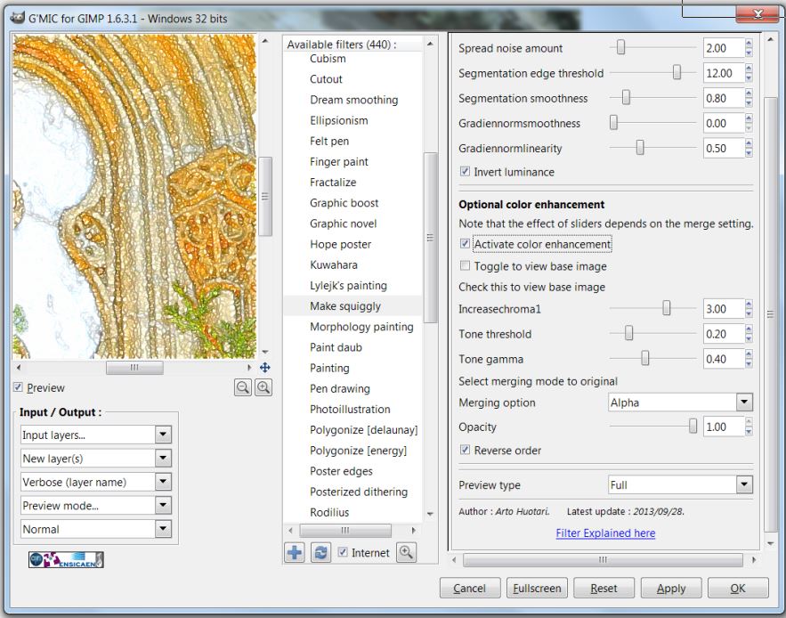

if the option "Activate color enhancement" is set ON, the filter crashes, see attachment
author of the filter: Arto Huotari

Dinasset, I have the same problem as you. :(

Stills works fine for me; using 64-bit version of G'MIC for Windows GIMP. :)

I have same problem on Linux Mint 17.1 64bit. I get error message and Gimp crashes. I have Gimp 2.8.14 and Gmic 1.6.3.1.

I have the same problem. I even get an error when I render the image with the plugin. The error is:
*** Error in ./gimp_Squiggly/*if/ *** Command '-gimp_blend': Undefined argument '$4', in expression '$4' (for 3 arguments specified).
I use Windows 7 64 Bit G'MIC 1.6.3.1

Thanks for reporting, this should be fixed now.

Thanks, David!
Tested, it's OK.
