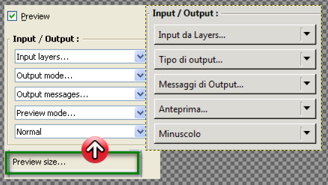

My countryman POGO compiled for me Gmic from git.
Translating acts great for windows now (never earlier)
Technical attention for monitoring - after is starting Normal - should be probably Preview size...
Is possible to to add (on solid) correction Samj for version portable?
- Modifier gmic.cpp pour assurer la compatibilité avec nos versions Gimp Portable
        if (!_path_rc) _path_rc = getenv("GMIC_PATH");
        if (!_path_rc) _path_rc = getenv("GMIC_GIMP_PATH");
                    remplace :
