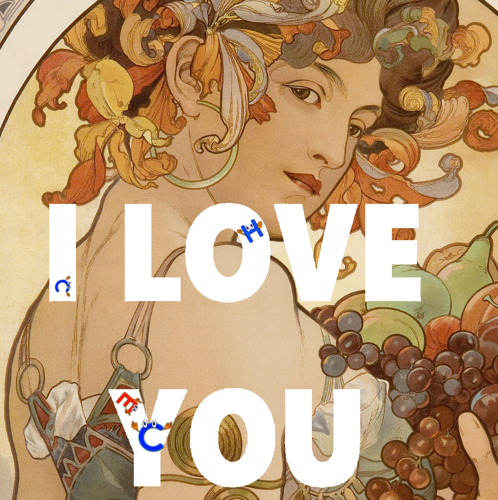

pack_sprites 10,10,3,-7,7,1
as you see, only the "angle" parameter has changed from 0 (do not change sprites orientation) to 3 (manipulate sprite orientation using any angle)
here the surprise, this is the outcome:
Fruit-Alphonse-Mucha_BG_pack_sprites 10,10,3,-7,7,1.jpg [ 413.59 KiB | Viewed 4808 times ]
is there a bug?

also using option 1 or 2 (180° or 90° angles) the text area in the outcome is either totally empty or showing 2 or 3 sprites

I suspect your letters to be too big.
When I reduce their size before applying the filter, it works for me.
Also, the filter is slow indeed, because packing is a quite difficult problem and you cannot get an easy solution without a lot of iterations.
I don't think I can do anything about it.

your suspect is quite reasonable, even if the size is not so big (150*130), but my question stays there:
- why does it work properly if I choose degree=0 and not if I choose degree=any?
the size is the same, the parameters also
edit: my "suspect" is still on the code added to implement the "any degree" function, on request of some user (I guess Lyle); the "original" code - which works with "0 degree" - behaves properly
don't you have the same "suspect", David?

David, maybe I discovered the problem in the algorythm:
- the parameter "minimal scale %" is NOT taken into account when selecting "all degrees", while it is appropriately taken into account when selecting "0 degrees".
New test:
- as a base image just a squared hole (440*440) surrounded by a frame (image 640*640)
- as sprites a series of letters (only a few) with a quite big size (300*261)
- parameters: 10 numbers of scales, 10 minimal scale %, mask as bottom layer
Test1: option "0 degrees" : excellent outcome, sizes have been appropriately reduced to fit in
Test2: option "any degrees" : outcome with just one letter, NOT rescaled
- outcome of Test1
- outcome of Test2
hope this info can be useful
