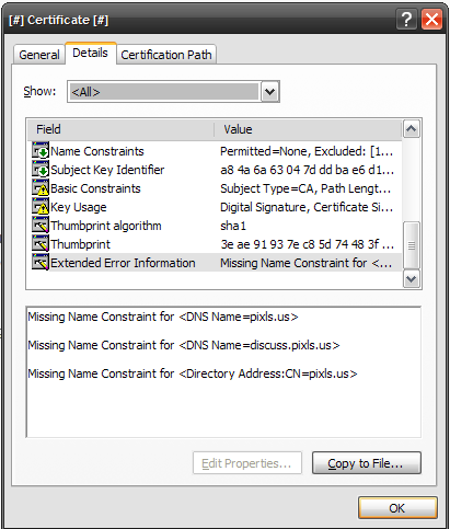

Attached the cert issues. All prime and sub certs are fine. Only one that's giving me a head-ache is the one in-between (Let's Encrypt Authority). Very strange. I tried clearing all my certs and everything (originally just the cookies and certs) per my conversations with Pat but to no avail. Weird. I am using Iron Browser and it may indeed be an issue with Iron since Chrome is working fine (based on your input). :)

Below's the cert itself (other tabs say things are hunky dory). :)

So I looked into this based in problems another iron browser user was having on winxp...
https://plus.google.com/+PatrickDavid/p ... 1&hl=en-US
Long story short, Windows XP is past End-of-Life, so the crypto API's are woefully out of date. (Cannot handle SHA256 signed certs, doesn't support SNI, and has problems with certs that have namespace restrictions).
I'm glad (though a little surprised) that at least you found a browser that you can use as a workaround - though honestly why not sandbox with a modern Linux instead of XP?
I'm also sorry for the problems. I have to make a decision between weakening security to accommodate an old OS, or drop support for it to support stronger security. :(
