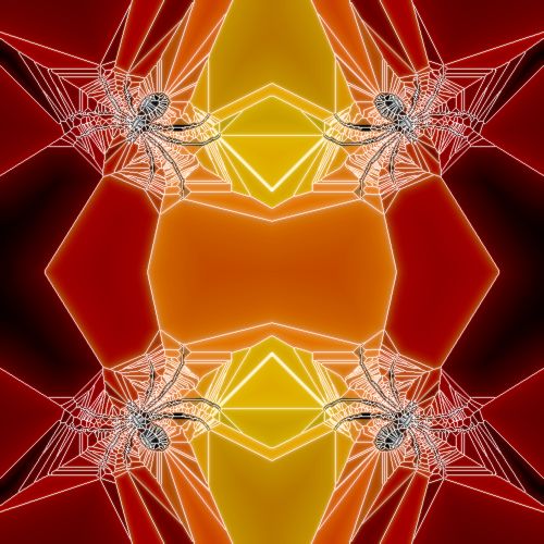

PostPosted: Tue Mar 29, 2011 9:06 am  (#10)
Very nice O :hi5 i like the colurs
Thanks O.
It isn't tile-able you will have to fix that if you want it seamless. :)
Great spider web effect!
Tileable or not everything could become tileable thank to the the Magick Mirrror included :hehe .
..you may get not just one several symmetric tiles even from that spider
Tile
'MIC] Mirrored array ; -gimp_array_mirror 1,0,0,2,4,0.jpg [ 66.16 KiB | Viewed 5400 times ]
Other tile (Much variants possible )
'MIC] Mirrored array ; -gimp_array_mirror 1,0,0,2,3,0.jpg [ 66.15 KiB | Viewed 5400 times ]
TILED
When is mirrored along both XY axes everything acquire vertical and horizzonthal symmetry :yes

Here's one with the spider mirrored.
 Post subject: Re: Gmic - Psychedelic Glasswork- ready for test
PostPosted: Tue Mar 29, 2011 9:28 am  (#12)
wow.. :clap :clap :clap :clap
we are in perfect syncronicity:
this is what i was going to post bedore see your message popping out (at soon i pressed the submit button)
and you just did something close !
i am wondering if add the option to run some preset (only as preset with no control to tweak, in case preset do NOT need to be installed )
As example the very last Oregonian-Spider-Pattern after Graphic Novel-Dark Moody
