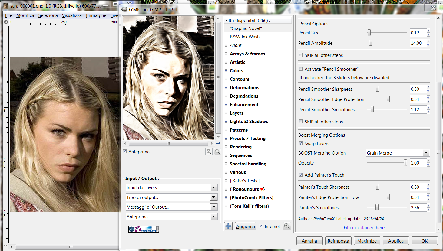

New version changes
1)
now is possible visual control on each step :
Check "Skip all other step" box allow to see what are you doing, instead then the final combination.
Anyway remember to Uncheck to reactivate the other controls.
2)
Merging modes:
i add a option to swap the layers before merging
and 2 merging option
please let me know if any problem
BTW i removed most of the notes in the filter for problem of space, let me know if is still clear, if not i may add them again (but then will be needed scroll even more to access to all commands)
