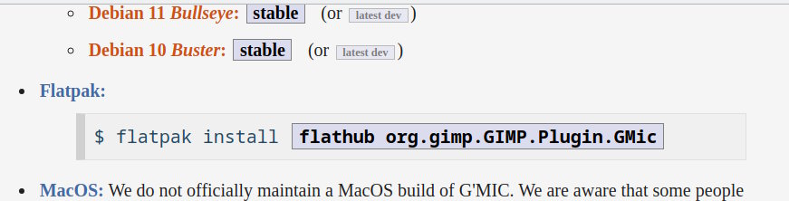

That is a fair point about the flatpak Gimp 2.10.34 It will not use a regular deb installation, it uses a flatpak version and the install directions are on the G'mic web page.
The Gimp version you use is up-to-you but there is a good regular installation for ubuntu 20.04 from https://launchpad.net/~ubuntuhandbook1/ ... buntu/gimp

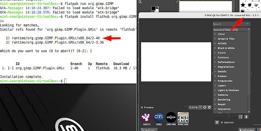

Using a flatpak installation and I have just done a clean install, you need to install a flatpak gimp_gmic_qt not a zip or a debian package. There is one snag, two versions to choose from and the 2-40 version works here.
If you run a flatpak list it should show what you have.
