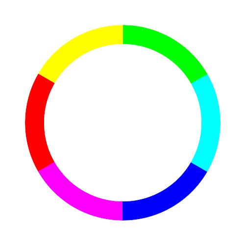

With default parameters, it would give:

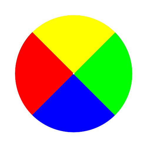

With default parameters except that "Internal Circle Radius Percentage = 1, Type = Opponent Model", it would give:

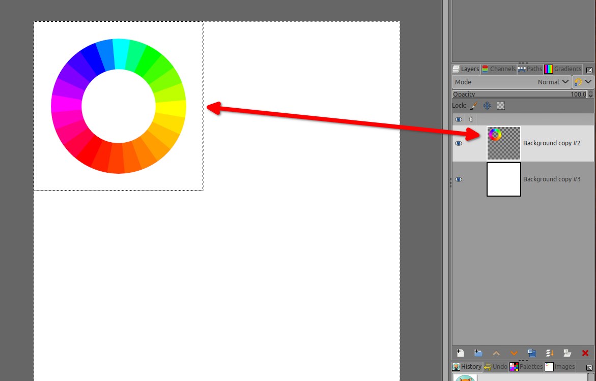

If I may, the only thing is that the result does not respect the size of the canvas, that would be a plus+ if the result would be on a layer of the canvas size (G'MIC 3.3.5 / GIMP 2.10.36 ), anyway it's very nice, thank you :tyspin
EDIT: forget what I said about the canvas size, I moved the External Circle Radius slider... and result get bigger :bigthup (sorry, I was asleep :oops: )
