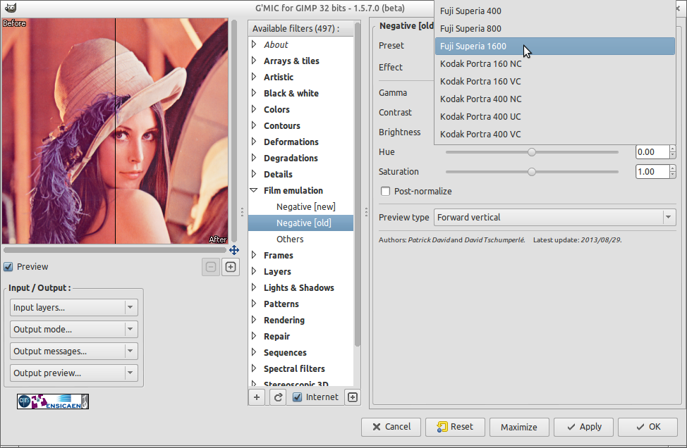

Here is a screenshot of the new filters in action :
Just update your filters and you should be ready to go (require 1.5.6.0+ by the way).
