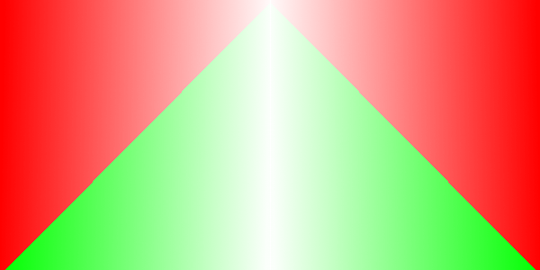

Hi Ron & GC
I started playing with the new gmic script kindly provided by Ron and commented by GC, and - what is my primary objective - I started also trying to understand each piece of code in order to be able to steal and create something.
First step I'm concentrated on is performing the fading effect.
So I tried to copy only that part but I didn't get any fading effect, so I came back to the full script FadedMirror and played with the values on fading and overlapping.
By doing so I noticed that the fading effect operates only on the overlapped part, if zero overlapping is chosen, even entering 100% fading no fading occurs.
I attach here 3 images:
1-original
2-faded-mirrored with parameters 0,0,0 (=x-axis, fading=0, overlap=0)
3-faded-mirrored with parameter 0,100,0 (=x-axis, fading=100, overlap=0)
images resulting from 2 and 3 are identical (alias: no fading in both cases)

To be more specific:
a - the new gmic function operates exactly as I like, for the purpose of stitching one image with itself reversed (in fact, in my simple python I had only one parameter, valid both for fading and overlapping)
b - my question in on the possibility for me to derive from there only the fading function to copy and paste it in another gmic function
What do I have to change from the first part of the code?
Many thanks...
(I attach here an image created manually with the result I thought would have been with 0,100,0; I repeat, not to alter the function which is perfect as it is, but to understand the code)
 Post subject: Re: @ Garagecoder Stitching images
PostPosted: Thu May 30, 2013 2:23 am  (#16)
PostScriptum: the image appears here with a fading into white, but is really fades into transparent....

Well, that is a slightly different algorithm in your case I suppose, as it involves the explicit creation of an alpha channel.
I would write something as :
foo :
  -remove_opacity[-1]
  100%,1,1,1,"255*(1-x/w)"
  -resize[-1] [-2],[-2]
  -append[-2,-1] c
  --mirror[-1] x
  -append[-2,-1] x
to return a 4-channel image with an alpha channel like this :
