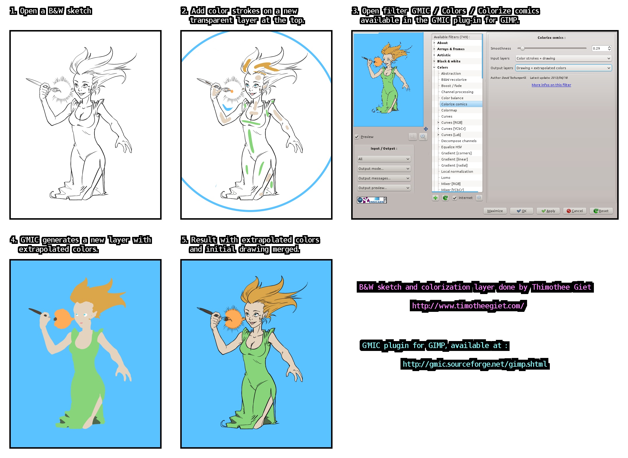

I've added another new filter in the G'MIC plug-in for GIMP (requires 1.5.6.0+), located in Colors / Colorize comics.
It is intended to ease the colorization of B&W sketch or comics, by trying to extrapolate user-defined color strokes the best it can, i.e. by following the geometry of the original B&W image.
I've done a self-explanatory image that describes the whole process :
The original sketch image has been taken from René van Belzen on Flickr (http://www.flickr.com/photos/aaipodpics/4897590498). The image is licensed under a CC-by-nc-sa creative commons license.
Note that when dealing with multiple layers for comics, a good idea is to consider them in the 'multiply' blending mode.

Hi Ronounours,
My version is still 1.5.4.0 because it does not like to be too constantly updating programs. And very recently had upgraded the GMIC.
My question is about what would be the difference between Colorize Comics and Recolorize? Both the G'MIC on Colors.

The difference is that 'Colorize comics' is focused on comics :)
'Recolorize' will spread only the chrominance informations from the color strokes you put on the top layers (so keeping the luminance of the photograph behind unchanged), while 'Colorize comics' will spread all the color informations on the image. It doesn't try to preserve the luminance information of the underlying sketch. That makes a huge difference.
Also, the priority map used to spread the colors is different. For 'Colorize comics' it is computed regarding the fact that you are using a sketch like image. It won't work with regular photographs.
