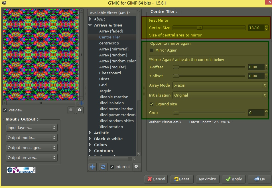

CENTRE TILER FOR GMIC
Apparently here there are far too much controls for a "simple " filter :hoh
BUT there is only 1 relevant option, the first , that determine how large should be the centre , how much of the original image will be used
the filter will mirror the central image along all axes
and this is already sufficient most of the times to create nice seamless pattern .

This is the essential function of the filter , controlled by the first slider
About the other controls , here below , they correspond to that of a built in filter (gmic>arrays and Frames> Mirror Array )
They may be useful here
1)
to guarantee the final image seamless ( in rare cases where the first mirroring was not sufficient to make seamless , for sure a second will solve)
and/or
2)
to extend the pattern size without loosing quality
and/or
to modify the reflection creating new "seeds" by cropping and/or offsetting
Waiting feedback... as example :
to determine "centre" size you prefer width/height locked, and a single slider to control both, as now or you would like more separate controls for Height and Width ?

#@gimp Centre Tiler: gimp_ctiler,gimp_ctiler
#@gimp : sep = separator()
#@gimp : note = note ( "First Mirror ")
#@gimp : Centre Size = float (17,0,50)
#@gimp : note = note ( "Percentage of central area to mirror")
#@gimp : sep #@gimp : sep = separator()
#@gimp : note = note(" Option to mirror again")
#@gimp : Mirror Again = bool (false)
#@gimp : note = note(""Mirror Again" activate the controls below")
#@gimp : X-offset = float (0,0,100)
#@gimp : Y-offset = float (0,0,100)
#@gimp : Array Mode = choice(2,"x-axis","y-axis","xy-axes","2xy-axes")
#@gimp : Initialization = choice("Original","Mirror X","Mirror Y","Rotate 90 deg.","Rotate 180 deg.","Rotate 270 deg.")
#@gimp : Expand size = _bool(true)
#@gimp : Crop = int(0,0,100)
#@gimp : sep = separator(), note = note("<small>Author: <i>PhotoComix</i>.      Latest update: <i>2013/8/16</i>.</small>")
gimp_ctiler :
size=$1
-crop {50-$size}%,{50-$size}%,{50+$size}%,{50+$size}%
-gimp_array_mirror 1,0,0,3,0,1,0
-if {$2==1} -gimp_array_mirror 1,$3,$4,$5,$6,$7,$8 -endif

yes the filter works but i am not more sure if add to my source because ...
well i just repost here my message to the gmic group
PhotoComiX says:
Not more sure if add this filter to my source , :
i had the disturbing sensation that all that may do is a subset of what Mirror Array filter already may do (using as reflection 2xy-axes and "crop" as needed)
...and even a vague memory of David advising me about long time ago surfaced to my mind
I fear that then i wrote i totally overlook the "crop" option of the Mirror Arrary filter , and that using smartly "crop" is possible get same results .
Waiting for feedback, if there are idea on how to modify to allow other effects not already included in MIrror Array i may edit (or you are free to do ).
If not i think i will let in my drawer
As now the only changes i have i mind are
1) separate controls for cropping H and W
(leaving a option to have them locked as now )
2 a option automatically split the 4 sectors in 4 separate images
...useful but maybe not sufficient to justify a new filter that doesn't offer much new effects
