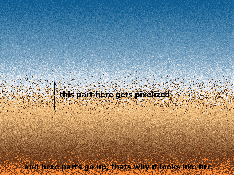

a question for all the great G'MIC programmers
in Photoshop there is this filter called 'Glass' and with it you can give an image the appearance as if it is behind frosted glass
my guess is, the closest we have is G'MIC -> Deformations -> Water
i tried it, but no matter how i fine tune the sliders, the result is not as nice as in PS
the texture is not as fine and it seems the distortion is mostly going up in G'MIC, while in PS it seems to go sideways
is there a way to improve the Water filter ?

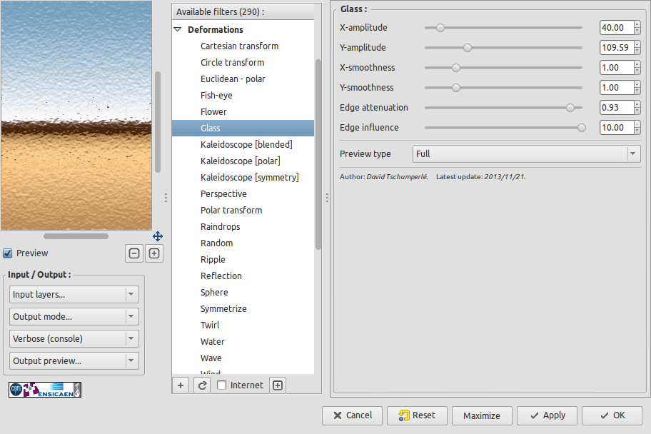

Hi Esper,
Nice idea indeed, does this help ?

the graininess looks good
but when i get the level i want, it also gets ripped apart, because everything seems to be dragged up, if you understand what i mean
i have no idea how this filter works, so obviously i cant give any input how to improve it
but it would be good if everyting could be frosted without being ripped apart so much
i mean if this was real frosted glass, stuff would look warped but not stretched that much

But, doesn't it go better if you decrease the 'Amplitude' parameter ?
I don't really see what you mean by 'dragged up'.
Maybe I should have different amplitudes and smoothness for the 'X' and 'Y' axes ?

So, here is version 2 of this filter, maybe the new controls can help.

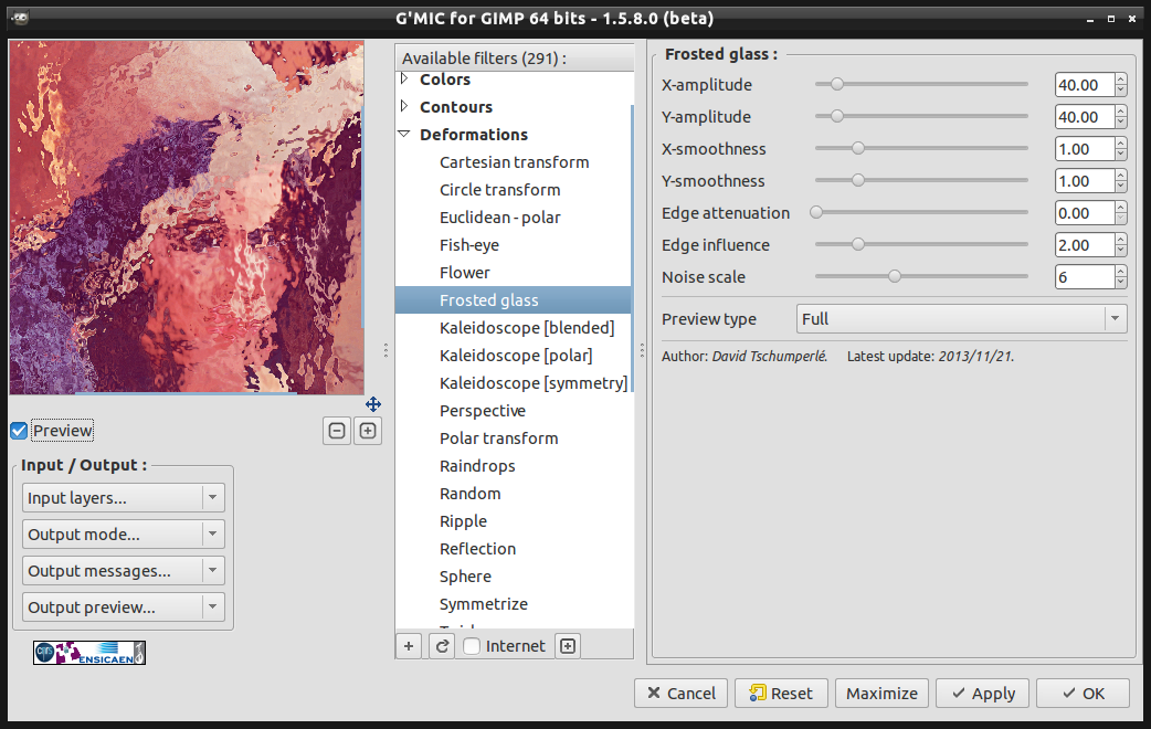

Ha, Rob, using a plasma as the basis for the warp noise is indeed a good idea :)
So, I've added a new slider Noise scale to the G'MIC Frosted Glass filter to allow the use of a plasma (of a given scale) instead of the regular uniform noise (still available when scale is set to 0) :
