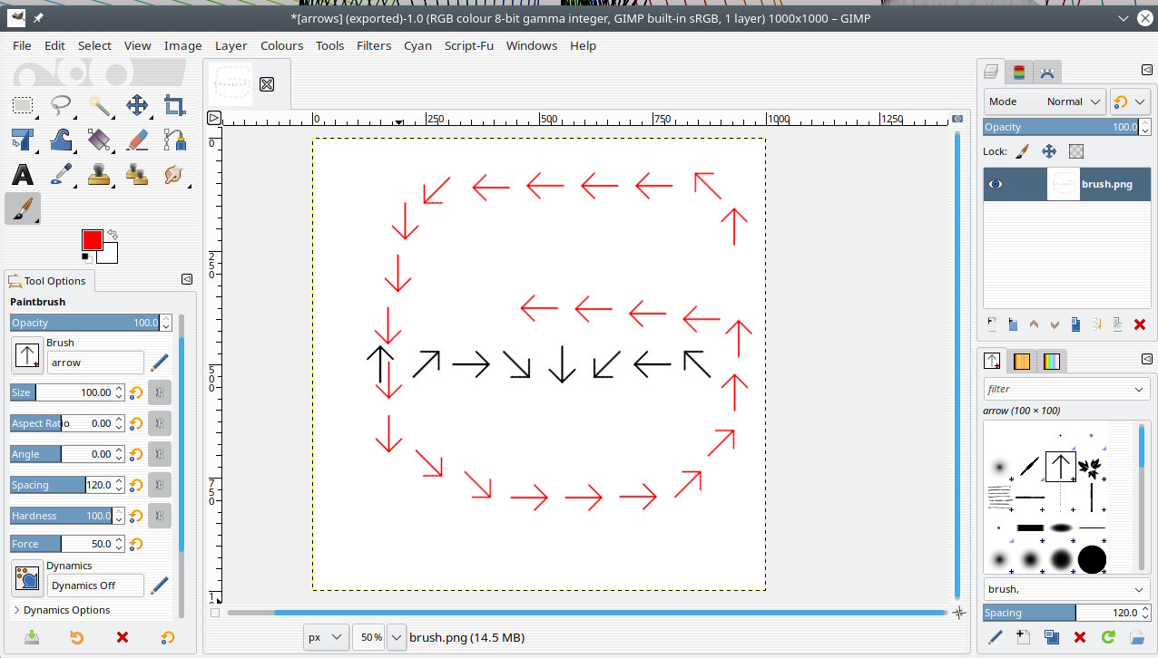

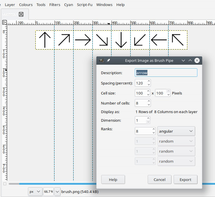

Sometimes it is easier to visualise the gih by creating the image as a strip rather than layers.
This time grayscale, takes the FG colour.
Its fascinating how much unexplored potential is in the brushpipe mechanic.
However i have a hard time seeing how working with a strip has any advantage when you have to rotate each cell.
With the clone layer tool you can make a brushpipe with many layers on one mouseclick.
