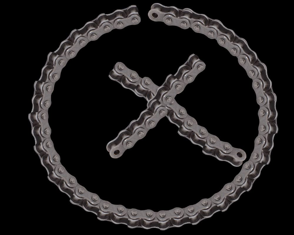

Well I made my first animated brush a Motorcycle Chain. It took way too long to rotate manually....
Chain-Bike.gih.zip [3.84 MiB]
Downloaded 311 times
 Post subject: Re: Animated Chain Brush
PostPosted: Mon Jun 01, 2020 8:28 pm  (#5)
Yeah, its tedious work. After 300+ rotations, my eyes had had enough, and I am still searching for RobA's script.
BTW, I added 6 to angle and your bike chain performed much better on my computer. In case anyone uses it and has problems.

Thanks also for the chain brush, Mahvin. Really great! Racer, your bike chain is very realistic!

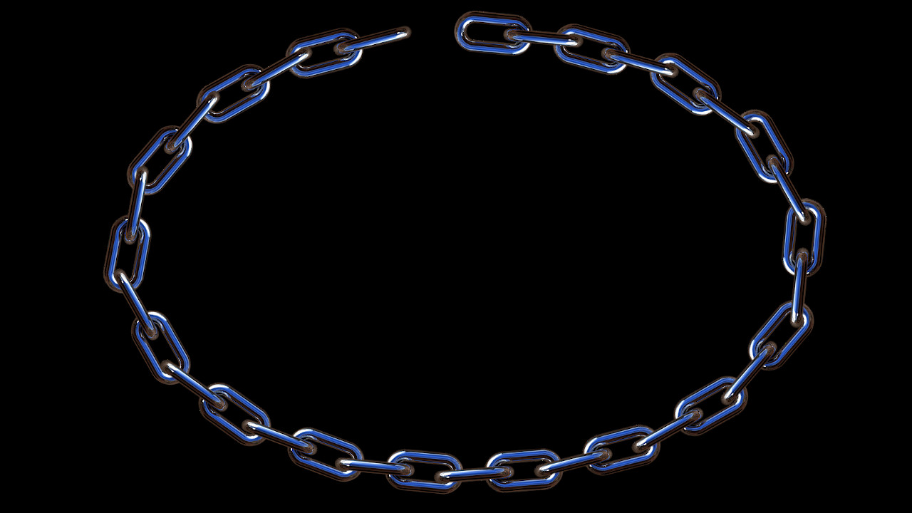

I made an animated chrome chain and it can be colorized into gold color if you want.
Chain-Chrome2.gih.zip [1.56 MiB]
Downloaded 264 times
PostPosted: Tue Jun 02, 2020 1:59 pm  (#17)
That is nice! Shiny, too!
