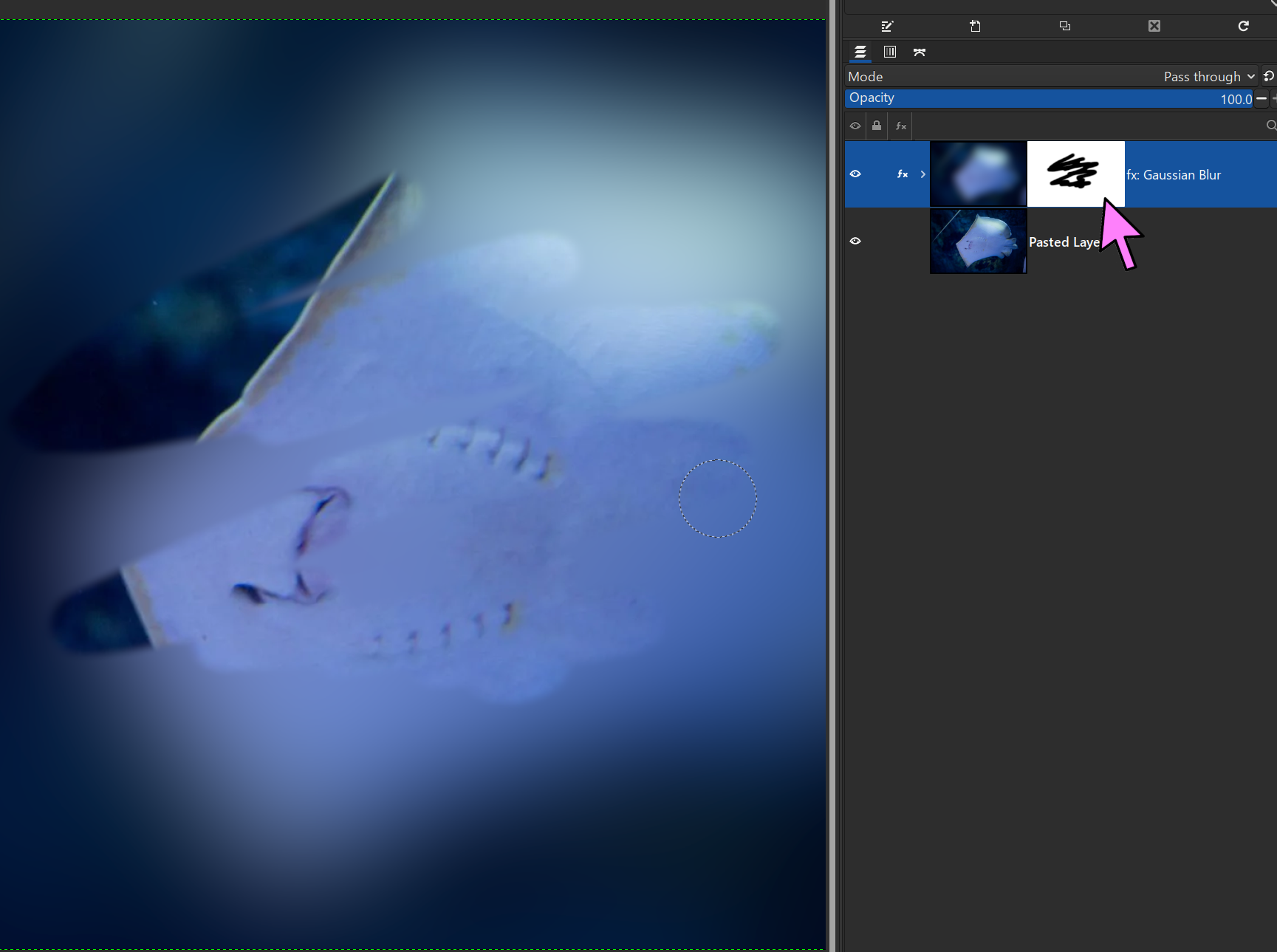

2. Layer Masks:
When you apply a filter, the plugin automatically creates a Layer Group with the adjustment filter attached.
It also automatically adds a Layer Mask to that group (based on your active selection).
Of course, you can also apply a layer mask later on.
You can paint black or white on this mask to hide or reveal the effect in specific areas, just like Photoshop's adjustment layers!
Give it a try, and let me know how it works for you!

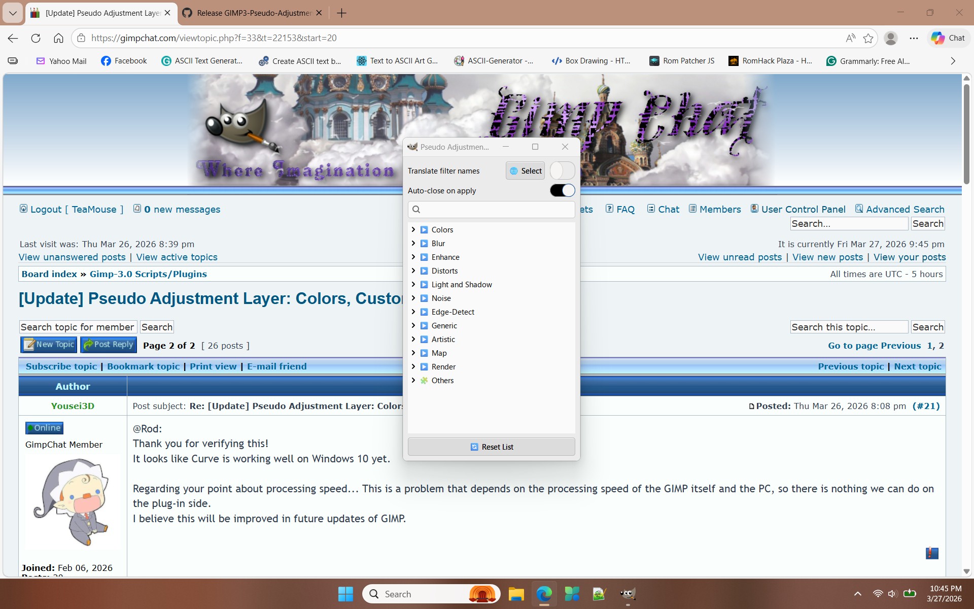

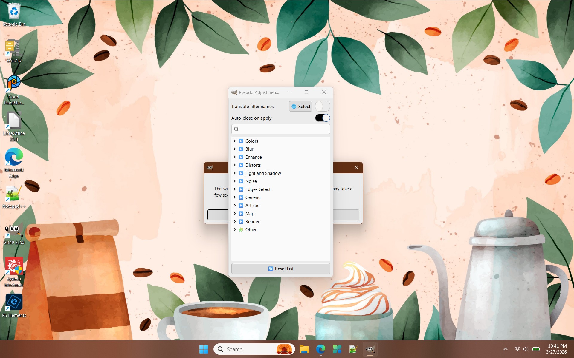

Things did not go well
Did a reset list and the window popup behind as shown in image. Once
I pressed the Enter Key I got a list of error messages on the right. Close everything and tried again.
This time I move the adjustment window to the far left and still the same thing.
Couldn't get Gimp to close this time, so I had to go to the task manager and close Gimp there. But
still had this.
This time I had to close Gimp and Python in the task manger.
Had about 10 or so error messages after I tried the enter key on the first time,
the third time I tried the Gaussian Blur, all it did was create a new layer and blur it for me,
no options to adjust, and I tried painting on this layer and it said this layer was not paintable.
The second attempt, still the same, all three with the same error messages.

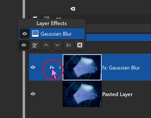

3. "Layer not paintable":
You were likely trying to paint directly on the Layer Group folder. GIMP does not allow painting on folders. To apply the effect partially, you must select the Layer Mask (the white box right next to the folder icon) and paint on that mask with black or white.
I hope this clears things up! I will release a new version with the popup fix and other improvements very soon.

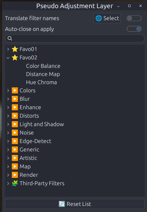

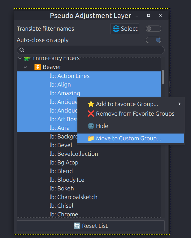

Pseudo-Adjustment-Layers Ver1.8 is released.
New features:
- Multiple Filter Selection
- Multiple freely named Favorites
- Organize third-party filters by grouping
- Translation setting function from the plugin UI
GIMP3-Pseudo-Adjustment-Layers Ver1.8
https://github.com/yousei3/GIMP3-Pseudo ... tag/Ver1.8
Tested with GIMP 3.2.2 on Windows 11 and Linux Mint environments.
If you have any problems, please let us know.
