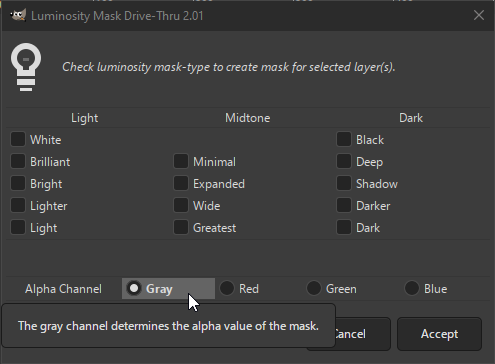

Hi,
I updated my Luminosity Mask Drive-Thru (LMDT) 2.10 plugin to Gimp 3 RC 1.
The plugin was tested on Windows 10, but should work with Linux. LMDT is designed to create luminosity mask for selected layer with and without a selection.
File comment: This is the default dialog.

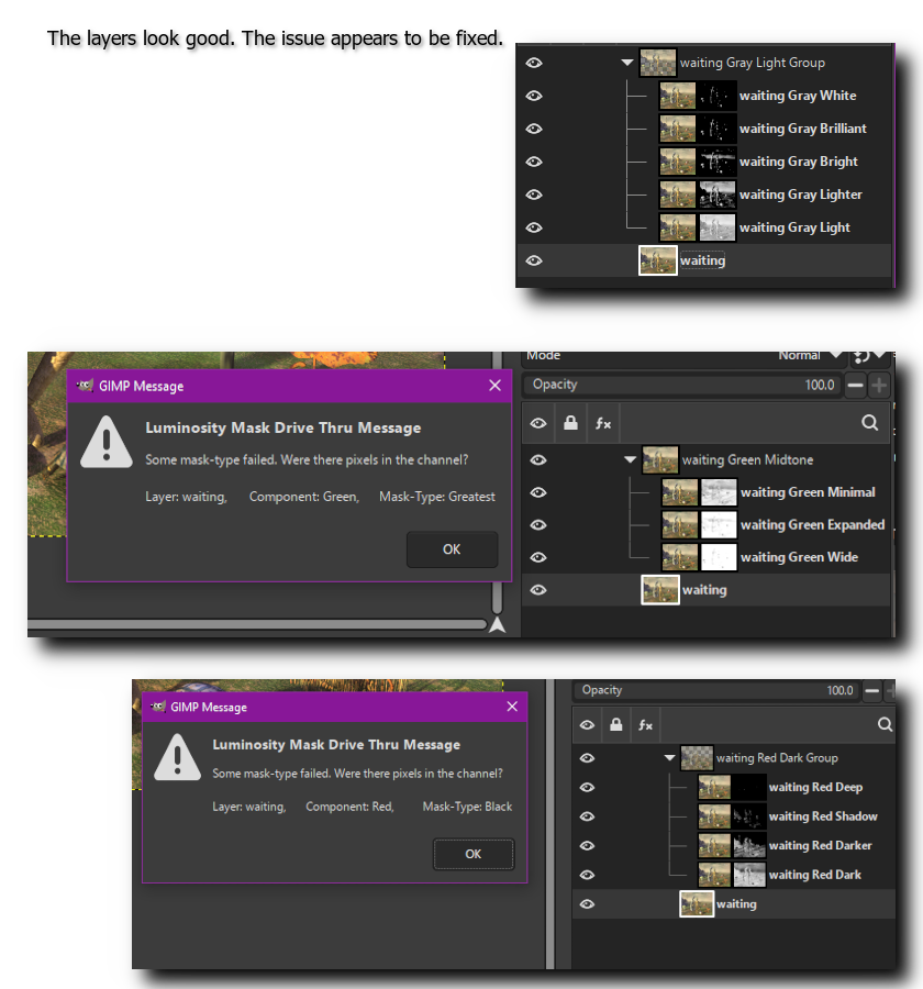

I fixed a problem with the 'Selection Channel' option. I hadn't quite rapped my around the option. In v2.01, LMDT correctly generates the alpha channel mask based on the component type during layer masking. I also renamed the "Selection Channel" to 'Alpha Channel'.
Here in the layer dock, the mask changes per the "Alpha Channel" option.
File comment: The image is made from red and blue.
I've added the Alpha Channel compenent to the mask-type fail Gimp message:
File comment: The mask cycling resulted in no pixels for the mask-type.

Here is an image of LMDT's v2.01 dault dialog.

Was the problem you were referring to the language translator? I fixed the missing translator in this version, 2.02. While I was at it, I found a bug where some mask-type generation failures were not reported.
Mask-type aren't guaranteed to create a mask, because these mask-types are based on pixel luminosity. For example, a completely black image will cause all of the Light and Midtone group mask-types to fail.
As an alternate to mask-type failure, the plugin could generate a black mask, but why create a mask that basically does nothing?

Thank you very much MareroQ for your help. I believe I've fixed the inverted layer naming problem.
File comment: The layers stack is in order; the masks appear correct; the failures sync.

Thanks again, Mr. Q. I believe I've got it fixed this time. I did some additional factoring, so that helps me get to a correct solution.
LMDT automatically removes empty mask groups which occur when the mask-types fail. The problem with the Midtones was an inverted option check. One line of code, and it all goes wrong.
File comment: I'm over-confident that this is correct.
