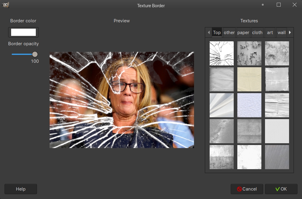

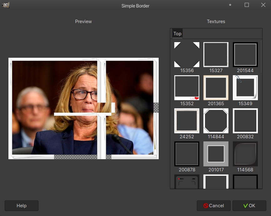

I suppose this is the bug with simple-border that you were referring to. Hopefully it can be fixed.
