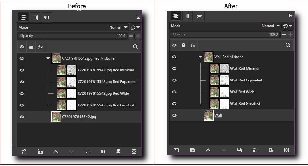

Here's what it can do:
File comment: The layer names are changed.

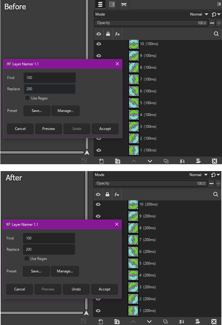

Hi,
I made a few improvements to Layer Namer. There's are new Preview and Undo buttons, and a Regex option. Here is a before and after example:
