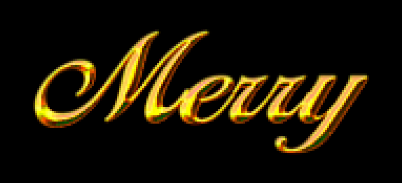

Im talking about this superb goldtext, Wallace posted in the Christmas post:
viewtopic.php?f=11&t=16057&start=100
Im fascinated how good it looks and the many shades it has (like green and dark red, and a desaturated orange)
So far i've been able to locate the font and what i think is the base colour.
You can download the font here:
https://www.dafont.com/de/font-comment. ... text=Merry
and the yellow base colour is probably something like: #fcff01.
Wallace said he used a script-fu: bevel and colourcurves to get the many shades of the highlights and shadows, but im struggling with recreating it, because i dont know what colours he started with.
@Wallace: do you remember what colours you used for the shadow and highlights ? Any special surface or gloss contours ?
Whats your usual workflow with curves ? Do you make curvy adjustments or just drag the start and endpoints up and down ?

The font was ballantines-script-ef-bold.ttf.
ballantines-script-ef-bold.zip [37.03 KiB]
Downloaded 169 times
I believe I used this gradient on the text.
_Silver.ggr [779 Bytes]
Downloaded 170 times
I honestly can't remember what color I used,
or if I just used the colorize filter.
I did run color curver on it and the script-fu-layerfx-bevel-emboss (inner bevel),
using the default settings.
I did it very quickly and wasn't thinking about reproducing it.
However,
using a gradient helps to make it look more like metal,
when color curves it applied.
Sorry I can't offer any more info,
but it was a quickie that I whipped up on the spur-of-the-moment.

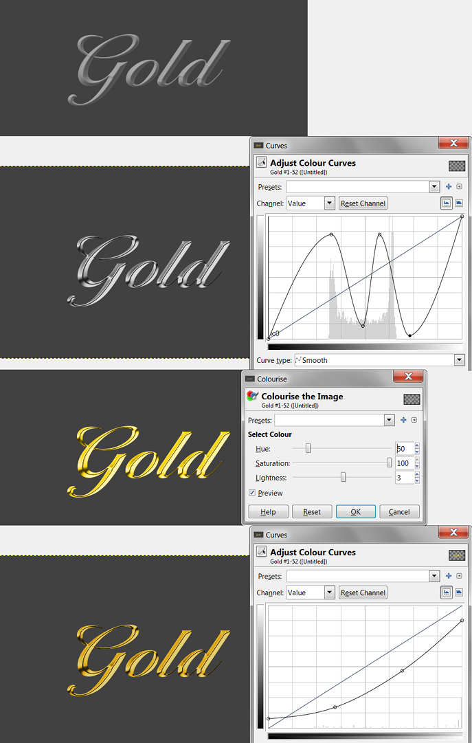

There is a base workflow,
which can help in creating metallic looking text.
It involves the use of gradients,
much like the gradient I posted.
There's also the use of Gaussian Blur on the gradient.
Most important is the use of Color Curves,
to give that metal like appearance to the text.
The colors use in the gradient seem to go from a dark gray to a light gray.

The christmas text I created was no accident.
There is a known workflow for creating metallic text.
The above images were made with a dark dray to light gray gradient.
The bevel and emboss script us run on it and then blurred.
The color curves was then applied.
Then I used the colorize filter.

Maybe im overthinking the whole thing.
Heres my workflow:
type text in #808080 grey (ballantines 160px)
bevel (with merge down) (Depth 10, Size: 3)
lock alpha channel and blur the bevel slightly (3px)
apply chrome curves
Colourise
apply more curves (Value)
The result is okay, but not as epic as yours...too much black, not many shades, no subtle greens and oranges, wrong goldcolour, etc.

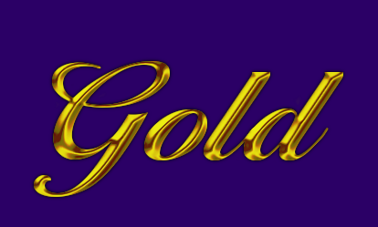

this ones a bit better, but i wish there was a more reliable and reproducable workflow, especially when it comes to the colourising step

Nice!
Varying the gradient (gray) colors and using a Gaussian blur
can produce different outcomes,
when the color curves are applied.

Okay,
no problem.
As we already mentioned,
it's the gradient,
along with color curves which helps make the effect happen.
I do this almost instinctively most times,
when I want to make metallic text.
Sometimes I do it in grayscale and other times in RGB.
The gradient used,
will oftentimes dictate the resulting color curve.
I also use paths,
made from the text to help give more depth to this.
By adding an outline behind the text.
