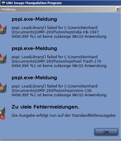

Hello,
When I use Photoshop plug-ins under the PSPI.EXE
I get the following error message when starting Gimp:
Can this message be turned off?
Best regards, Hardy

Hello,
the filters work perfect. It is only the error message.
Could have been someone knows a trick.
Best regards, Hardy

Hi Hardy.
Probably our installed after 2 versions: 32 and 64 bit.
Only 32bit works for Gimp (because pspi.exe is only 32 bit).
In your Flaming Pear filter examples, the download contains both versions - remove the 64 bit version (I could repeat your error message for the test).
