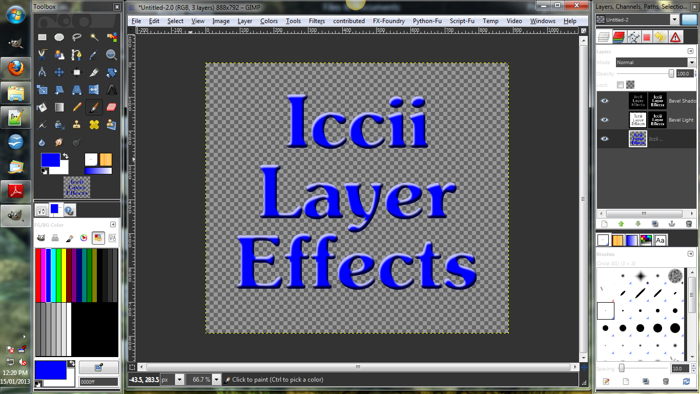

I think Iccii's layer effects may be worth keeping (it will need a little work though) because it gives a slightly different effect than the others screenshot below↓

Esper fixing iccii was easier than i thought

I've only fixed and tested the bevel and emboss part so far will get through the rest later
