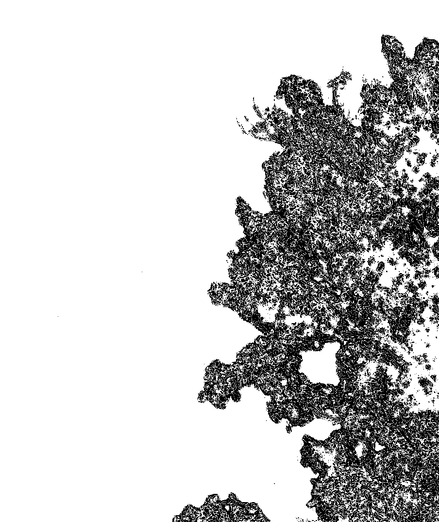

Using G'MICs Frequency splitting filter (smoothing 2.82) and then a threshold adjustment (125 135) on the structure layer (the grayscale one) I can get this as a first attempt:
Kevin
 Post subject: Re: Is there a way to create a busy threshold mask?
PostPosted: Thu Sep 26, 2013 8:38 am  (#20)
Posts: 12850
That's pretty much the highpass filter idea Kevin. Rob's idea does appear to hold promise. Still have to deal with the occasion hot bits though. Guess there isn't really a good way to test smooth voids. :)
