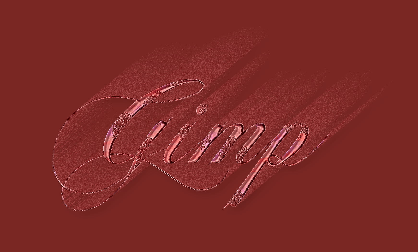

Decoding/Reproducing Sallyanne #332 "Wind dispersion"
I did like how the letters are "desintegrating" and their dust is spreading in a wind alike, and keep the rounded form of the letter at the bottom.
In the beginning, I thought it would be a piece of cake. Not so, as a matter of fact, I couldn't have been more wrong!
Sallyanne might have used a plugin for the text, the one with an emap (not sure, but it looks like), not having that map (if map there is) the effect on the text itself was quite difficult to reproduce, so I kind of passed on it as I did not want to use a plugin.
If you look closely, it seems that there is at least 3 types of shadow (a long one and 2 "normal" 1 dark and 1 white), plus the dark shadow is going in one way, they another way, giving this nice effect it's going out from the ground, but I told myself to keep it simple as it was already a long time that I was on it. The font is quite specific as well and if you got a font which is just a bit too thick, it won't work well (I did tried and meeh, it was not good), so I needed to search for a similar one.
Without any further do let's get started.
Prepare your ForeGround(FG) / BackGround(BG) colors, respectively #ee9592 / #7a2724 (colors are just indicative)
Drag n' drop the BG color on the background layer Then un-tick the eye of that layer
Text tool > Write "Gimp" (or whaterver you like) Font size ~550 -> Italic, color white from the floating text dialog to not change your FG color (font used for this exercise is "Chopin Script")
Then right click > Discard Text Information
Name that layer "text"
Filters > Light and Shadow > Drop Shadow (legacy)... (this is very important use the legacy!!) use default setting (4,4,15,60,x)
Now you have a new layer below "text" called "Drop Shadow"
Make sure the layer "text" is still selected
Then right click on it > Alpha to selection
Select the layer "Drop Shadow" > add mask > a window opens select "Selection" > OK
Select > None
Click on that "Drop Shadow" layer and put it above the layer "text"
Un-tick the eye of the BG layer > now your text is on a transparent BG (important step)
Then right click on that "Drop Shadow" layer > New from Visible
Now You have a new Layer which is called "Visible" -> Rename it "bumpmap"
you can tick the eye/visibility of the BG layer and un-tick layer "text" and layer "Drop Shadow" (we don't need those last 2 anymore)
Select layer "bumpmap"
Erasor Tool > Brush "Cell 01" > few Dabs on the writing to make holes and look a bit grungy
Right click > Alpha to Selection
Select > Save to Channel (we need for later)
Select > None
Then Duplicate that layer (new layer become "bumpmap Copy")
On layer "bumpmap Copy"
Filters > Light and Shadow > Long Shadow
Style -> Fading (Fixed Length),
Angle - (minus)-40,
Length ~400,
Midpoint ~175,
Composition -> Shadow Only
Then
Put that layer in Mode "Dissolve"
Duplicate that Layer (it become "bumpmap Copy #1"),
Filters > Light and shadow > Drop Shadow... (the normal one this time)
Right click > Alpha to Selection > Add Mask (selection checked - Invert mask checked)
Then opacity of this layer at ~50%
Select Layer "bumpmap" (the one below the two pink shadows)
Put it Above (on top of the layer stack)
Then
Filters > Distorts > Emboss... (Emboss type -> bumpmap, Azimuth ~340, Elevation ~75, Depth ~25)
Filters > G'MIC-Qt.. > Details > Tone Mapping > Increase smoothness to your liking (~1) > Output Mode - New Layer > Click "Apply" (not OK)
Still in G'MIC-Qt > Details > Tone Mapping [Fast] (it's just below) > Channels(s) -> YCbCr [Green Chrominance] > Output Mode - New Layer > Now Click OK
You got 2 new layers "bumpmap #1"(chrome alike) and "bumpmap #2" (pink), put "bumpmap #2" in Mode "LCh Color" 50% opacity
New Layer on top name it "map"
Gradient tool > FG to BG (RGB) > Shape "bi-linear" > From the center drag down to around 50 pixels before the edge
Warp transform tool > then make a mush like below (be carefull to not have transparent part => untick visibility of the background layer to be sure)
Add mask Select/tick "Channel" (don't forget to un-tick "Invert Mask") > Put that Layer in LCH Color (opacity 100%)
Result
As always, If you are the OP of this text effect and did use a different method, please feel free to add it, it would be interesting to know how far or closed I was.
If someone has a faster, simpler, or just a different method, please share as well, it's always interesting to know that there are multiple ways. :bigthup
To be Continued...
Patrice

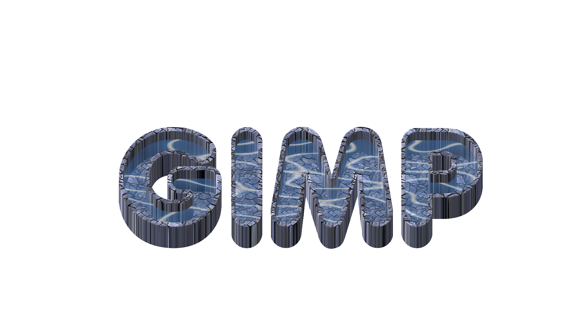

Oh no - i posted my 204 trial in the text forum ..
PixLab - here is my attempt from your notes, and from links, and from OMG
first i had made one, not deep enough that i was trying to do
then i did make it deeper and i had used two extrusions which ended up not matching
So- finally since i now had the water in the right place in the middle, i just went back to
my initial 'wall' outline layer and did a single extrusion to the right size
(ps- can you tell me if the 'double-post was OK? or is it best to link the posts,
so that there are not double images?)

Nice to see how you did handle it :bigthup
That's a great job @leftyleo :clap
No problem, that's very OK :bigthup

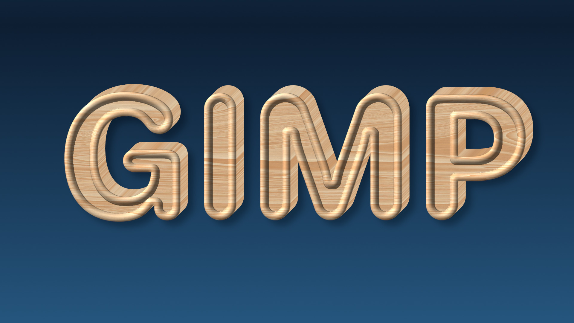

Decoding / Reproducing racer-x #70 wooden text
I like wood text, this one is what I call a "classic".
We can see that racer-x did use a home made texture, thus we will do our onw ;)

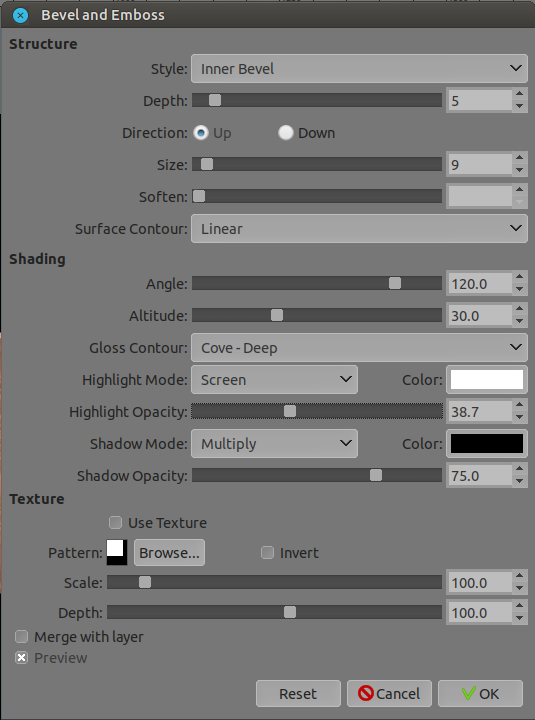

Extrusion was internal going toward the center of the text and there is a "bevel - emboss" on top of it (so we do need to make a map)
Racer-x said "I used Layer-FX and Extrude-3D", so we know how he did it (thank you), thus we will take a different approach as s/he used plugins...
I will use only native GIMP's tool like that every one will be able to do it (and yes it's super easy, reading this tuto will take way longer than doing it ;) )
New image...
1) Text
Text tool > Write "GIMP" (or whatever you like), Font size 550 > Colour White (font used for this exercise is "Roboto Heavy" from the free Google fonts)
Right click on the layer text > Alpha to Selection
Select > Save to Channel (important)
Un-tick the eye/visibility of that Text layer (no need any more)
Select the Layer below "Background" Name it "white text" > Fill selection with white color
Select > None

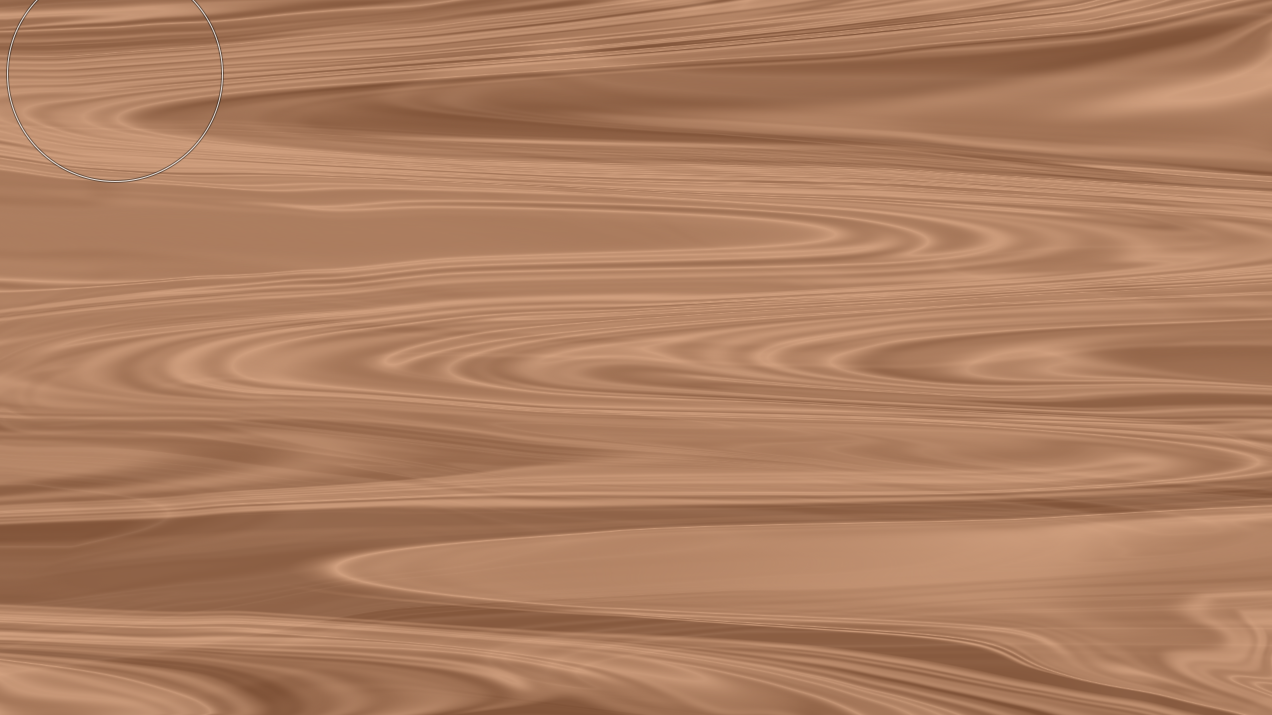

2) Texture (2 layers "fibers" and "plank")
This is how I do my quick textures, if you prefer your own, do your own now then go directly to > 3)
Prepare your colors NOW > ForeGround is "d1a07f" / BackGround is "7f5237"
New Layer name it "fibers" > fill with BG color
Then Filters / Noise / CIE lch Noise... Click Ok we just want some noise by default
Then Filters /Distorts/ Wind.. Strenght > Full throttle at max, then OK
---------> [**] Then Filters / Blur / Median blur... > Radius = 1 (or don't blur now but after the next step as it will be more "visual" and you will "see" the "varnish" effect once layer "plank" is made)
New Layer name it "plank"
(this layer is the base of many "quick" textures I'm processing, like stones, water, ice, metal, and so on)
Gradient tool > FG to BG (RGB) > Shape Bi-linear > start from the ~center and drag down to the edge (stay at ~50 pixels from the edge)
Then Warp Transform Tool > size ~300-350 / Move Pixels mode / Interpolation > None (it goes way faster) Abyss policy > Clamp to not have transparent area inside!!!!
Make a mess, you can call your kids to do it, they will love it ;)
Once you've played enough, put the Warp tool on one side (near the top) and go straight to the over side, do the same just below but start by the opposite side, and so on (vice-versa), for two or three more time/row
You should have something like below as a result
Put this layer "plank" in mode "Overlay" at ~78% Opacity (you can play on it with Filters / Enhance / Sharpen (Unshap mask).. if you like a more rough wood)
--------->[**] If you did not blur the layer below this one ("fibers") before, do it now, or don't do it if you prefer a more rough textured fiber-ish wooden texture
Then
Right click on the layer "plank" > New from Visible, name that new layer "Visible" -> "texture"
3) Textured text
Now un-tick the eye/visibility of all the layer below "texture" (but not "texture")

---------> B) For lazy people with the plugin Layer/ Layer Effects/ Bevel and Emboss...
Just take a look at the setting below ;)

You're Done!
Result

Wood texture (2 layers named fiber and plank)
Prepare you FG/BG colors
FG = f2e1cd
BG = daaa82
New Layer (fiber)
Fill with FG color > Then Filters / Noise/ClE lch Noise.. > Then > Filters / Distorts > Wind... (strength 60+)
New Layer (plank)
Gradient FG to BG (RGB) > Bilinear > Repeat Sawthooth Wave
Warp transform tool > Move Pixels > Size ~300 > Hardness/Strength ~78 > spacing 1 to 5 > Interpolation Linear > Abyss policy Clamp (to not have transparent areas in the image) >
make a mess by moving the warp tool everywhere
Then right to left and vice-versa (like my previous post) with the Warp transform tool.
Then put this layer in mode Multiply
Right click > New from Visible
Un-tick "fiber" and "plank" (no need anymore)

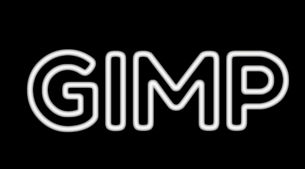

3) Map:
Create New layer (name it B&W map) -> thus "B&W map" should be above "wooden bump"
Then > Select / Shrink... > 10 pixels
Select / Save to channel (name channel "shrink 10")
Then go back on the last layer > Select / Border... > 10 pixels
Select / Save to channel (name channel "border 10")
Go back to the "B&W map" layer > fill selection with white
then Select/Invert > Fill with black
Select / None
Then Filters/Blur/Gaussian blur X and Y at 5.50
Then go back to channel dialog > select "border 10" channel (don't tick the eye, just select it), then Channel to selection (button at the bottom of the channel's dialog or right click on the "border 10" channel)
Go back to the layer "B&W map"
Select/Invert
Select/Shrink 5 pixels > fill with black color
Select/None
Un-tick the visibility (we don't need it to be visible)
Now we have a nice map to render bumpy rounded effect

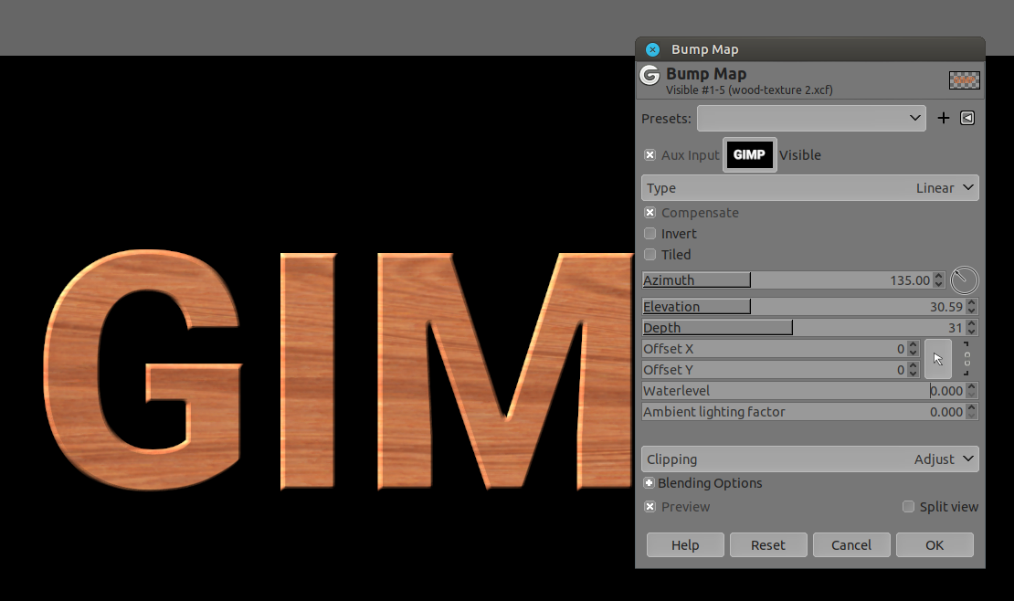

Go to layer "wooden bump" and make it visible
So by now, as visible layer you should have only the black backGround and this one (wooden bump) > select the later(wooden bump)
Filters/Map/Bump map... > Aux Input select the layer "B&W map"> Type Linear > Compensate is ticked > Azimuth 135 > elevation 45 > Depth 25 > Ambiant lithing factor 0.444
