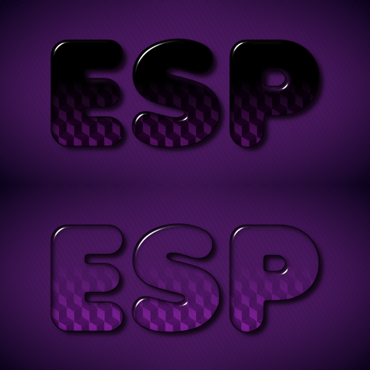

i was really surprised the blur for the bumpmap made by xgeous was only as small as 3
interesting fact !
mostly i go for 10-12
 Post subject: Re: Gel/Water Effect Experiment
PostPosted: Wed Mar 06, 2013 11:29 am  (#34)
Joined: Jul 17, 2012
Posts: 2769
transcript of xgeous video-tutorial:

xgeous: that's really interesting. i didn't think the difference would be that big!
esper: very nice, looks cool with the glossy black.
