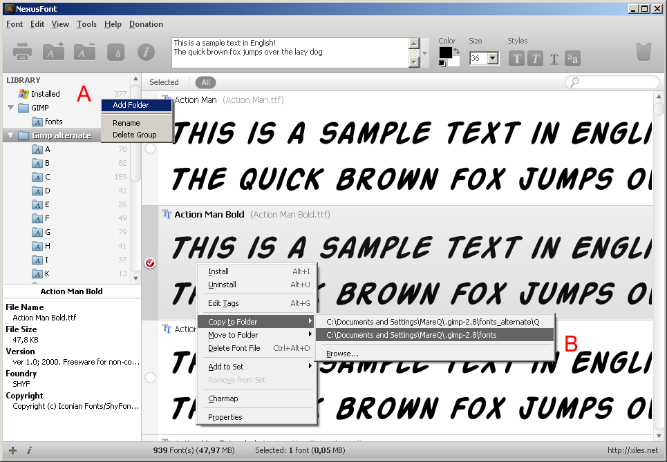

1. Download and unzip Switch Font.zip.
2. Switch Font.py is a plugin (which requires that you have Python - how? http://www.exp-media.com/content/extending-gimp-python-python-fu-plugins-part-1).
3. Place the Switch Font.py in the appropriate directory (how? http://gimpchat.com/viewtopic.php?f=8&t=719).
4. Open the file Switch Font.py in Notepad + + (http://notepad-plus-plus.org/download/v6.4.2.html).
5. Check lines 15 or NexusFont.exe located in this path: C: \ \ Program Files \ \ NexusFont \ \ NexusFont.exe - if NO - EDIT the program directory path NexusFont.
6. Restart Gimp (if it was running).
7. The GIMP-click PPM on any font.
8. In the dialog box, select Management Fonts ...
9. In the new window-management python_fu_font_switch Select program NexusFont
10. If all goes well the Nexus is booting up.
11. Share your fonts into groups [A] - PPM menu NexusFont - You can add any fonts in Gimp (C: \ Documents and Settings \ YUR NAME \. Gimp-2.8 \ fonts \) - an advantage -[b] that choose a font that you can see.
12. Reload fonts in Gimp and you can use it (without restart Gimp).
