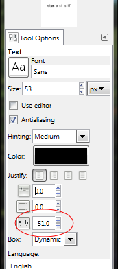

I didn't read the entire thread, but I did find this to be a reason for backwards text. Adjusting the letter spacing to a large enough negative value creates backwards text. I don't know what solutions anyone else has come up with.

Backward word was created by having a large negative letter spacing such as -57
PhotoMaster the bug was (pressing the reset button at bottom of tool option window) did not reset the letter spacing to 0.0 and was fixed in 2.8.10
