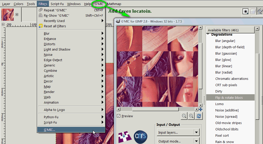

Another old method (more durable) - to add a new location with the small plugin (py)
#!/usr/bin/env python
#-*- coding: utf-8 -*-
# based on the idea "Gimpscripter" https://github.com/bootchk/gimpscripter [ http://registry.gimp.org/node/25305]
def plugin_main(image, drawable):
  pdb.plug_in_gmic (image, drawable, 0, 0, run_mode=RUN_INTERACTIVE)
if __name__ == "__main__":
  from gimpfu import *
  register(
    "python_fu_plug_in_faves_gmic",
    "Shortcut to favourite plugins",
    "This plugin was created using GimpScripter...",
    "Bootchk - modified MareroQ",
    "GimpChat",
    "No copyright date",
    "<Image>/G'MIC",
    plugin_main,
  main()
Gmic_gimp_faves_locatoin.zip [544 Bytes]
Downloaded 264 times
 Post subject: Re: How to place G'MIC in GIMP's Image menu
PostPosted: Fri Sep 02, 2016 10:54 pm  (#7)
Thank you very much, MareroQ. It worked. G'MIC is in the main image menu after the Help. I seem to have one problem after another lately with my computer or maybe it is Gimp. I have another entry that keeps appearing in the main menu if though it has been removed.
PostPosted: Wed Nov 30, 2016 8:44 am  (#17)
Joined: Nov 30, 2016
Posts: 2
This is an excellent solution. Kudos and thanks to MareroQ.
Personally I have a very small problem with this particular configuration though. The G'MIC menu item behaves like a button, in stead of a menu. It requires two clicks to open the G'MIC dialogue. In the case of editing the menurc file as mentioned above, the G'MIC menu contains a sub-menu item also called G'MIC, which brings up the G'MIC dialogue, either on click or button-release. This is more conventional.
So, if I may suggest a slight alteration to the py script, making the menu it creates behave in the same way as the menurc solution, change Line 18 to "<Image>/G'MIC/G'MIC",
Now the menu item behaves like a menu and not a button, and the position of the menu is better placed, and not after the Help menu. You can change the name of the submenu item to say, "Launch.." instead, or whatever you fancy. The basic idea is to have the menu behave like menus and not buttons.
