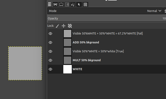

Hi, everyone. I haven't visited for a long time. I've been working. (at my age!)
Some of you may recall my abiding interest in (ab?)using Gimp to make grayscale heightmaps for CNC carvings. (PegLeg44 is another, and predates me.)
I upgraded to 2.10 as a result of a new Ubuntu install (I think's how it might've happened), and have been happy to discover my "images" can now contain 65535 grayscale levels (if I set Image->Resolution to 16-bit integer, and if I understand correctly).
I'm puzzling over the "arithmetic" involved in multiplying and adding layers. In short, I'd like to combine layers of equal maximum peak brightness (100%) by creating new layers for each by multiplying by a 50%-gray layer and then adding the two. In my mind, the two new layers should have resulting max brightnesses of 50% each and their sum then should have max brightness of 100% wherever the two's maxes overlap.
The results have not been as I expected, so I did a small test (attached) which resulted in a maximum brightness of only 67% instead of 100%.
Can someone remove my confusion and suggest a way to get what I'm after?
[Incidentally, I also chose "Linear Light", instead of "Perceptual Gamma", under Image->Precision, and verified that enabling/disabling "->Color Management" in the same location made no difference.]
Thank you.

Referring to the Gimp docs, I can confirm:
* the maths for "Multiplication" of a Mask layer sitting above an Image layers is given as:
E=(M*I)/255
* the maths for "Addition" of a Mask layer sitting above an Image layer is given as:
E=min(M+I,255)
In my example, I=100%(255?), M=50%*I, everywhere.
The result of the lower multiplication is a new layer where:
E=(50%*255*255)/255=50%*255, everywhere.
The result of the upper addition should be then:
E=min(50%*255+50%*255,255)=100%*255
but it is 67%.
GraMP

Works as you expect if you use the "Legacy" mode on addition.
I suspect the new ("default") modes don't bluntly use the linear values, but do a gamma-conversion; otherwise, most blend modes wouldn't give the same result in "linear light" (which is itself more about storage than about processing).

Indeed, Ofnuts, just as you said: toggling between Addition and Addition(l) by choosing "Legacy" (instead of "Default") on the rightmost arrow pulldown (which offers to "Switch to another set of modes" when hovered over) instantly provides the result I expected!
(Now I'm curious if choosing legacy drops me back to 256 gray levels. Trying to figure out a way to test that.)
Thank you.
