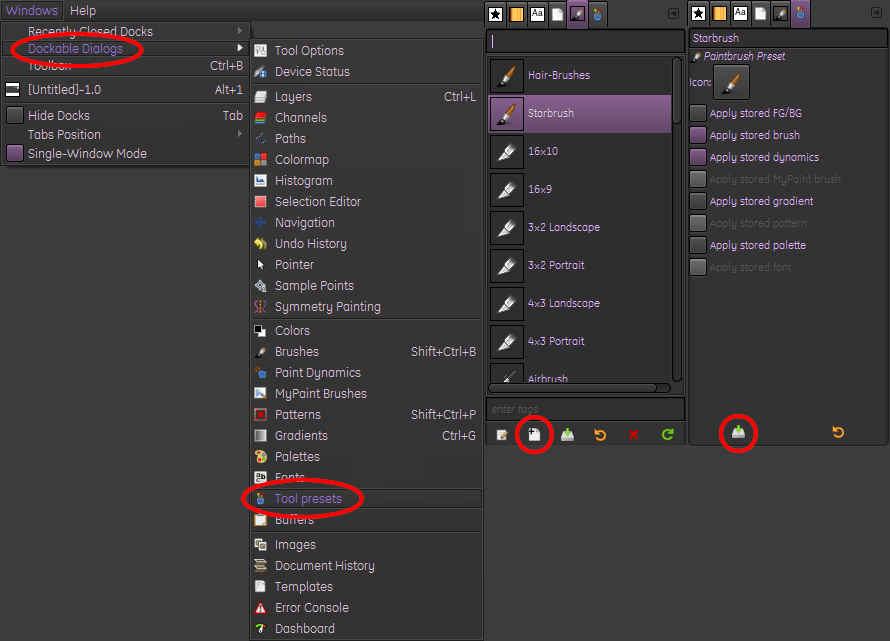

 Post subject: Re: Tutorial Question
PostPosted: Tue Oct 30, 2018 11:48 am  (#9)
Posts: 1442
Konstantin wrote:
Griatch wrote:
You can certainly link brush dynamics to brushes in GIMP, this is not a unique Photoshop feature.
orly
upload a Gimp brush that has an embedded dynamic
Did you try this? Not embedded in the brush, but technically same thing.
And lot faster if PS hasn't changed for the better from what I remember.
1. Select the brush you want to modify.
2. Change its dynamics and dynamic options.
3. Open tool presets. Windows/dockable dialogs/Tool presets
4. Create a new tool preset.
5. Select what you wish to save, dynamics, fg/bg, gradient and palette can be saved with brush.
6. Click "save the active tool.....button"
PostPosted: Tue Oct 30, 2018 1:48 pm  (#10)
Joined: Sep 20, 2016
Posts: 293
The point of my post was to explain the workflow of the video to the OP.
Understanding that a PS brush can have a behaviour tied to it, is essential when trying to imitate the technique.
I recently downloaded a set of PS brushes and they made barely any sense without the Brush Dynamic which of course got lost in Gimp.
Most of the techniques in the video can be replicated in Gimp, but a custom brush is seperate from a Brush Dynamic.
So if you wanted to share a certain brusheffect, you'd have to upload more than just the brush (be it a Dynamic, or as you showed a Tool Preset).
