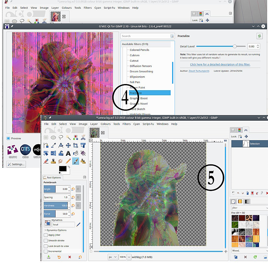

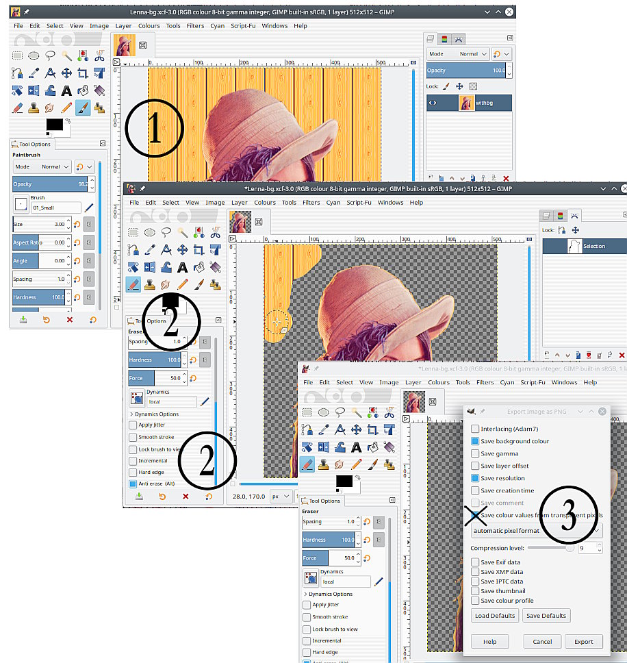

Probably a gmic filter. First a little bit of why?
Transparency is just a mask, initially it does not remove anything. If you use your Path -> Selection -> Cut procedure (1) Then use the eraser tool in Anti-Erase mode (2)'s You can recover those 'cut' pixels. There are options with some formats. For example exporting as a png, untick "Save colour values from transparent pixels" (3) The mask is still there but will show as a solid colour.
Not really a help with a gmic filter like (4) As far as I know, the only work-around is to keep a selection in place. Layer -> Transparency -> Alpha to selection (5). If it messes up the filter then save selection to a channel and apply the selection afterwards.
most of the time I make paths / selection / reverse selection to keep only the character and I have never used the anti-erase mode.

Eraser Anti-erase mode - just an example that the cut pixels are still there in some form and some gmic filters pick them up.
How you get round that depends on the filter. You already have the path. Apply again, and recut the background.
