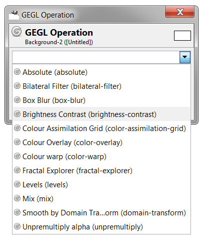

I just watched a video on youtube which uses a GEGL gradient map.
https://youtu.be/XmZjMgNDolU?t=24
However this filter is not in my Gimp 2.10.18 "Tools - GEGL Operation" list. In fact i have only 12 filters in my list.

I don't have it either.
Win 10 Samj's pack Gimp 2.10.19
 Post subject: Re: GEGL Gradient Map
PostPosted: Thu Jun 04, 2020 7:42 am  (#3)
It's there in 2.10.14 but in my 2.10.19 it disappeared (like 9 other GEGL filters...);

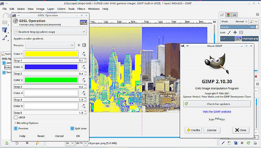

I don't think anyone has posted this but if you don't want the long list and only search for the function (Gradient Map), there is Colors > Map > Gradient Map. It's not exactly the same, but it works for me. You just need to edit the Brush/Pattern/Gradient area of the Toolbox.
PostPosted: Mon May 31, 2021 9:53 pm  (#7)
Joined: May 24, 2021
Posts: 859
Indeed it works well, but with almost no control (chose the gradient) nor visual adjustment ;)
On the other hand, Filters > G'MIC > Black & White > Colorize [with Colormap], is even better (IMHO) than the GEGL Gradient map and it has also more options ;)

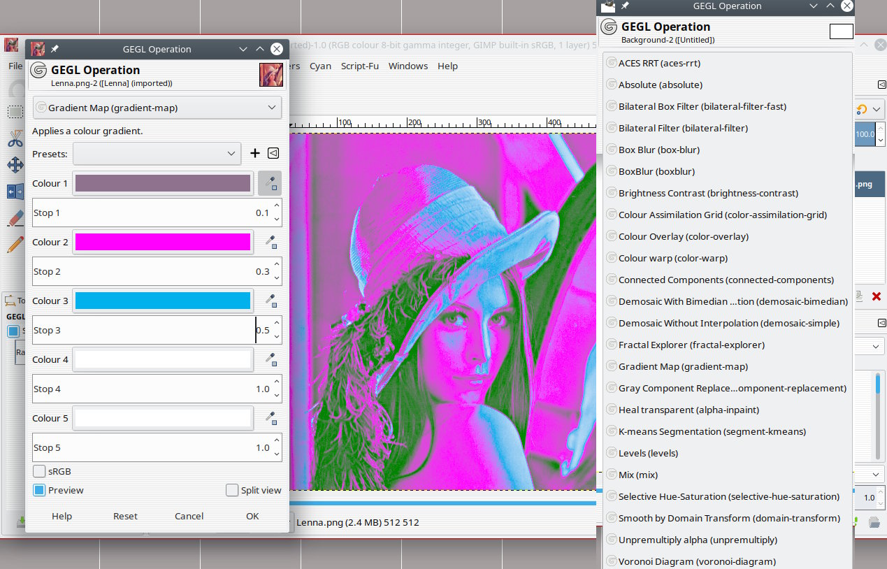

For a linux binary, you can get a libgegl-0.4 debian package from here: https://launchpad.net/~otto-kesselgulas ... /+packages
Unpack the deb for possible binary plugins. Example:

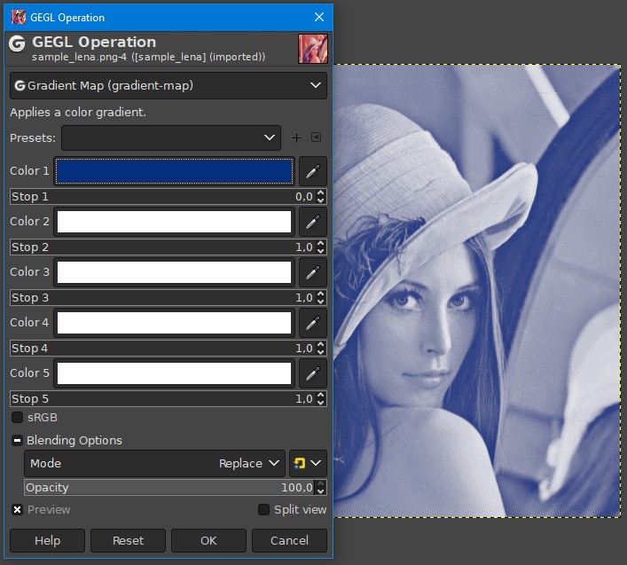

ImageHSL color goes good with Gradient map

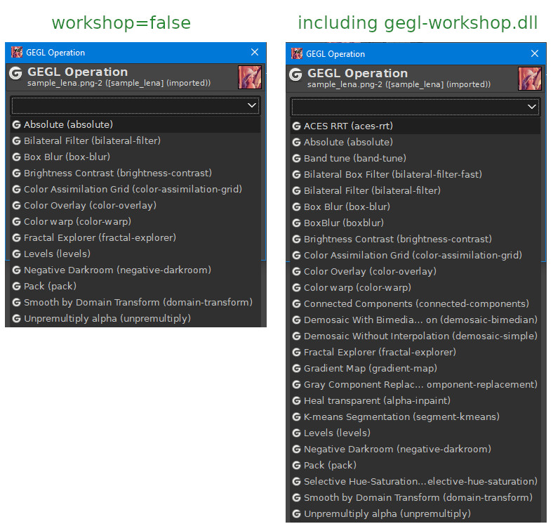

The case is a little different.
Lost Gegl Operations are available in GEGL code.
It is up to the compiler whether to include them - they are turned off by default as experimental (workshop = false).
Workshop contains (list of gegl-0.4.16):
aces-rrt.dll
bayer-matrix.dll
bilateral-filter-fast.dll
connected-components.dll
demosaic-bimedian.dll
demosaic-simple.dll
ditto.dll
domain-transform.dll
enlarge.dll
gcr.dll
gradient-map.dll
hstack.dll
inpaint.dll
integral-image.dll
linear-sinusoid.dll
rawbayer-load.dll
segment-kmeans.dll
selective-hue-saturation.dll
voronoi-diagram.dll
external:
gluas.dll
line-profile.dll
spyrograph.dll
generated:
average.dll
blend-reflect.dll
negation.dll
soft-burn.dll
soft-dodge.dll
subtractive.dll
File for Windows 64bit in the attachment WITHOUT ANY WARRANTY!

I do not know if anyone is interested in it, but apart from the information provided, I would like to add that currently (Gegl-0.4.35 in Windows) creates one file gegl-workshop.dll out of 17 source files:
aces-rrt.c
alpha-inpaint.c
band-tune.c
bilateral-filter-fast.c
boxblur.c
boxblur-1d.c
connected-components.c
demosaic-bimedian.c
demosaic-simple.c
ditto.c
gcr.c
gradient-map.c
integral-image.c
rawbayer-load.c
segment-kmeans.c
selective-hue-saturation.c

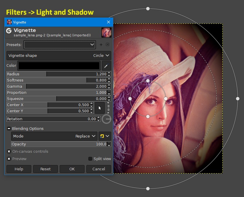

The Vignette GEGL Operation was more powerful than the one you can use in GEGL Graph. I did not see that on the list at all.
PostPosted: Thu May 19, 2022 11:07 pm  (#19)
This is a picture of me and my granddaughter I took with my cellphone, and then after running it through GMIC and using the gradient map.
PostPosted: Fri May 20, 2022 1:09 am  (#20)
Was this gegl filter different?
