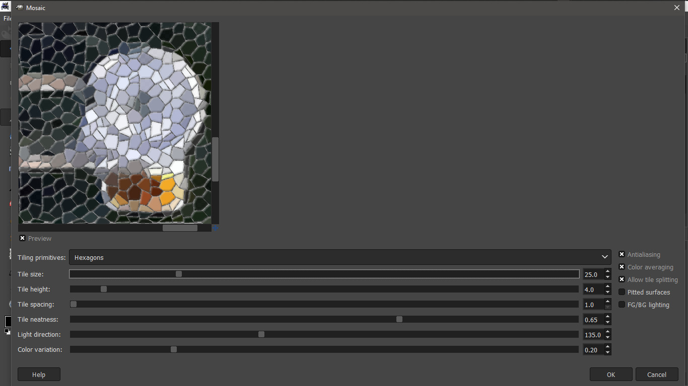

A Gimp 2.8 version ? I have one of those tucked away. From Gimp 2.8.22 Unzip, pop it into your user profile plugins folder. Find it bottom of Filters -> Distorts along with the other non-GEGL filters
linux-64bit-mosaic.zip [20.34 KiB]
Downloaded 158 times

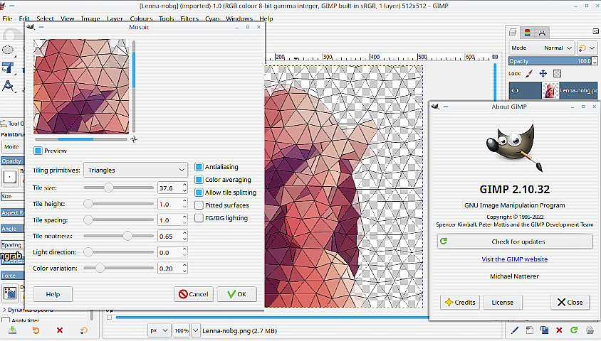

Posts: 16197
I still use the large preview Filters>Distorts>Mosaic filter and it works fine in Gimp-2.10.32 :bigthup
If anyone is interested i will upload the zip here.
