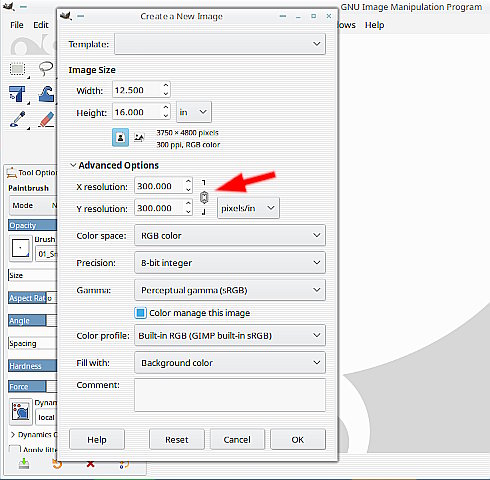

Lots can go wrong when you set up for a printer. First is the printing resolution, pixels-per-inch (ppi) and for a photograph quality 300 ppi is the custom.
Does not have to be that see: https://www.gimp-forum.net/Thread-Image-size-in-Gimp
For your project 12.5" x 16" that makes a background canvas 3750 x 4800 pix.

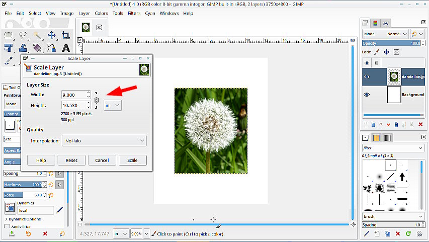

Open your photo File -> Open as Layers and that plants it bang in the center of the canvas
For scaling just that layer use: Layer -> Scale Layer and if you use inches as the units you cal set something 9" x whatever, the Width and Height are linked, change one changes the other. If you have to scale up or down a great deal then go back and review your original photograph.

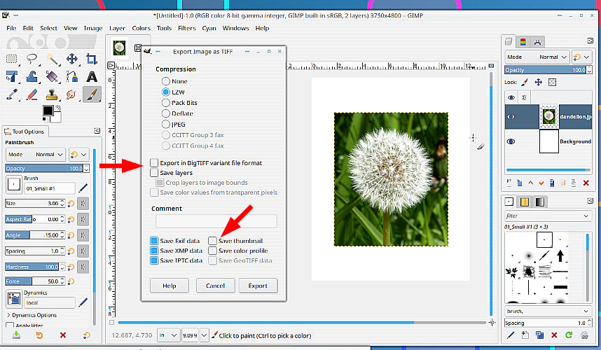

You still have two layers. Tiff format can keep layers as pages, that is probably why you printed a blank canvas. Two ways.
(1) Image -> Merge Visible Layers (keeps any transparency) or Image -> Flatten Image (loses transparency)
(2) Use the tif export and untick Save Layers.
Whichever way you choose, make sure Export as BigTiff and Save Thumbnail are unticked. Both can cause problems. Lots of things can go wrong, printing is a big subject.

Very, very true. The serious users have their monitors color calibrated. I use a laptop, not calibrated but with brightness turned down to get a better representation (I know my computer). Gimp does have a soft-proofing option see: https://www.gimp-forum.net/Thread-The-R ... t-Proofing but it is not 100% accurate when it comes to out-of-gamut colours.
If you are worried, crop a 6" x 4" area out and get a print of that. Look at colours / brightness / contrast that might need tweaking. Some good printers do that for free. (edit: or send you a sample/calibration print +image)
best of luck
