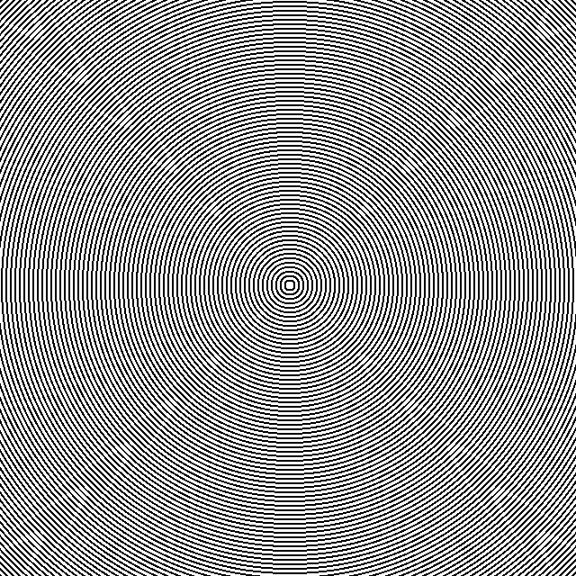

G'MIC's Edges offset with a dot in the middle to start things off. :)

Cool Lyle! :)

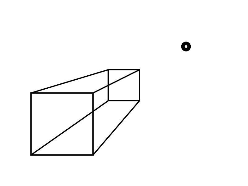

Quick mock-up for line drawing, numbers indicate the order of clicks.
Maybe setting first point should be separate so that several concentric lines could use same "vanishing point"?
