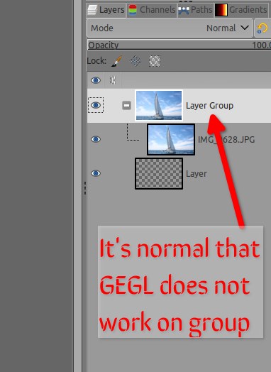

contrast_ wrote:
I'm going to fix that.
There is nothing to fix :hehe
GEGL filter work on layer, but not on layer-group and that's normal (at least it's like that in 2.10)
Select a layer-group and look in the menu like Filters > Blur, all GEGL filters are grayed

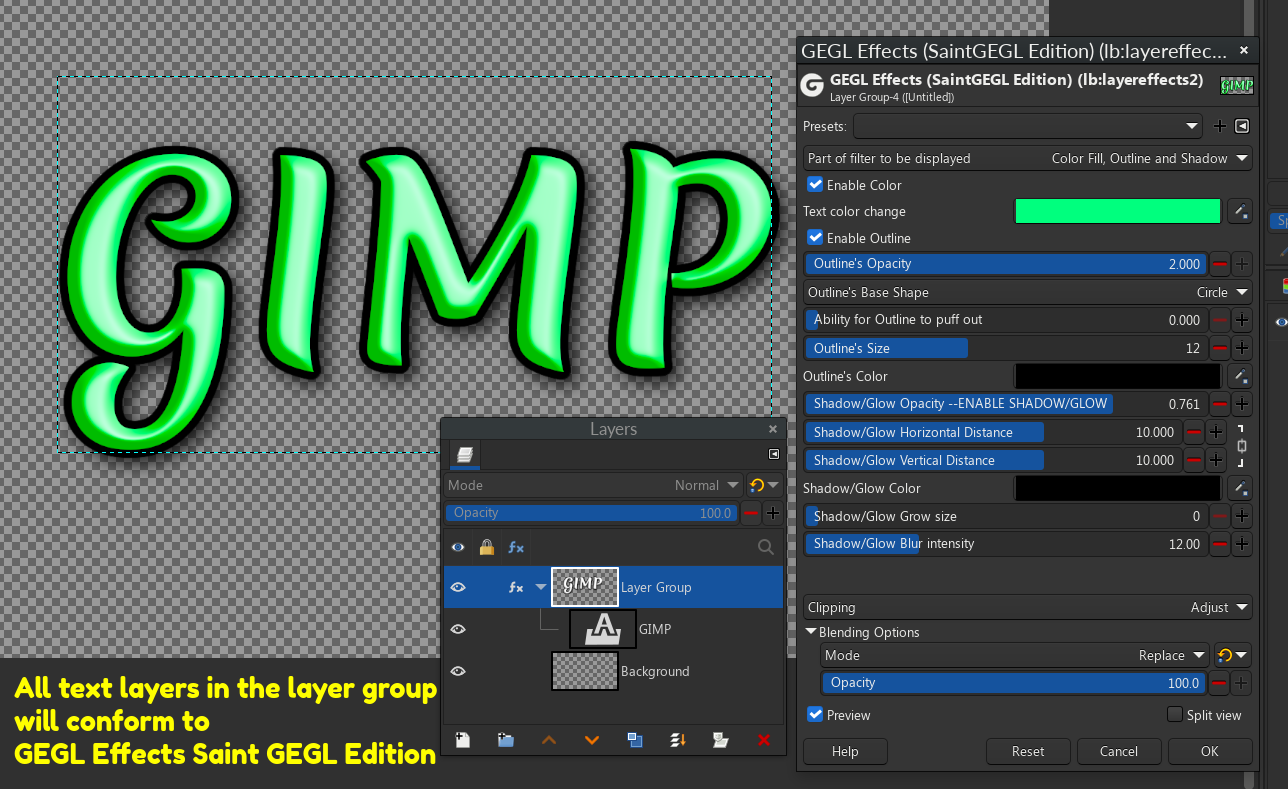

An alternative version of GEGL Effects for adjustment layer groups
I'm sure everyone who reads my post knows the GIMP 3 bunker repo is deprecated and has been removed from my Github. However the GIMP 3 bunker repo had an alternative version of GEGL Effects `sg:gegleffects` that version of GEGL Effects has the following listed features
1. works on adjustment layer groups
2. does not use zzstrokebevelimage
3. uses plugin ops of mine like custom bevel, ssg that normal gegl effects does not use.
4. Has a color on off disable checkbox
I am porting that build of GEGL Effects to my main Github as an alternative branch.
Put simply, GEGL Effects is getting another alternative version that can co-exist with the default. The alternative version works on layer groups. That is a huge deal in 2.99.19 because all text layers in the layer group will obey it.

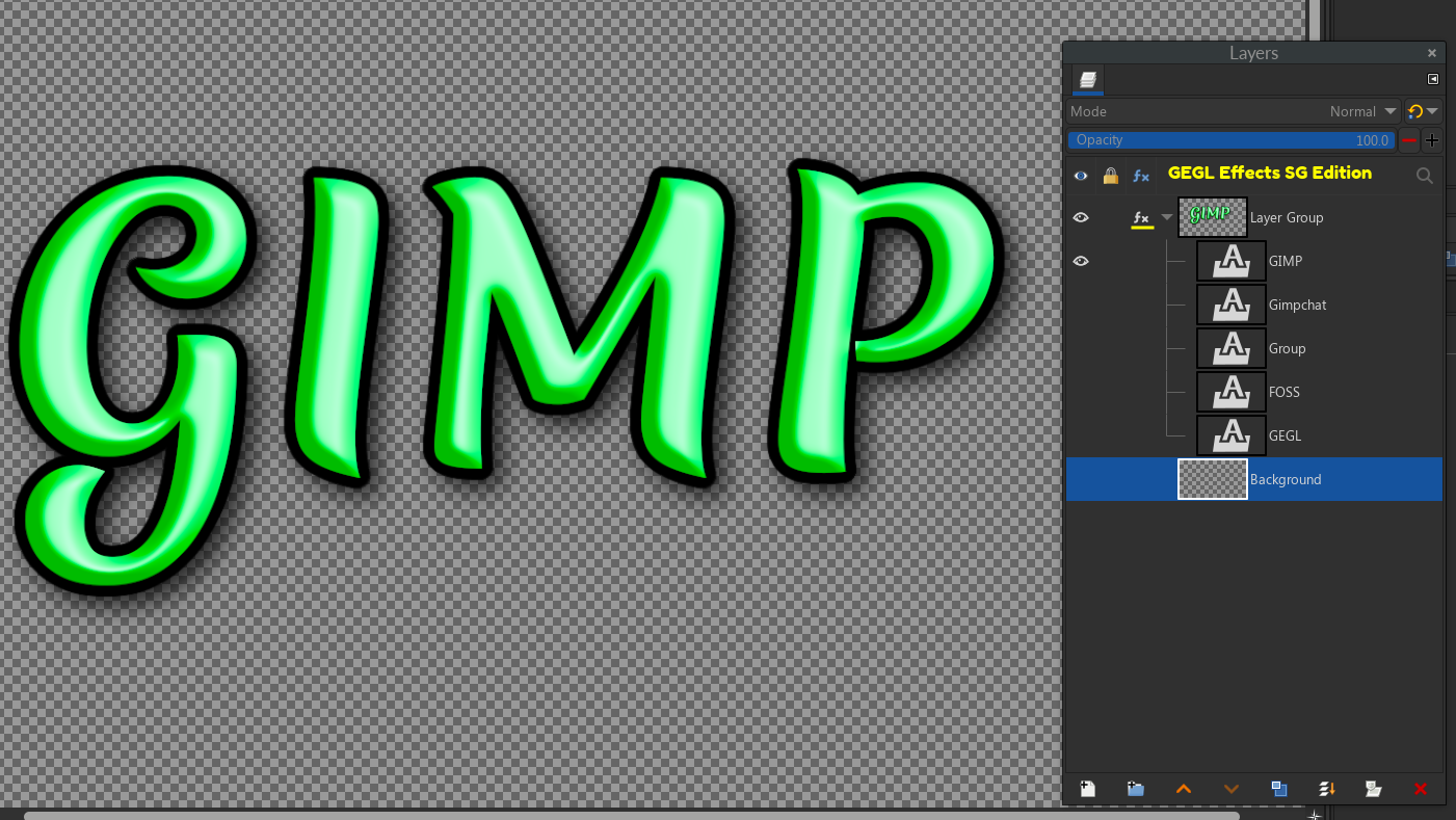

All the layers in the group will conform to GEGL Effects SGE
Every text layer in the group is effected by the same style
