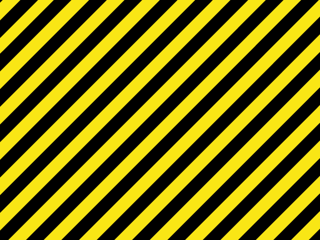

i love these industrial type of looking, yellow/black diagonal stripes
whats the best technique for creating them ? (by hand, with filters, scripts, paths, etc.)
i just made these by using rectangular selections, filling them with black and yellow and then rotating by 45°, then duplicating the layer and filling in the gaps

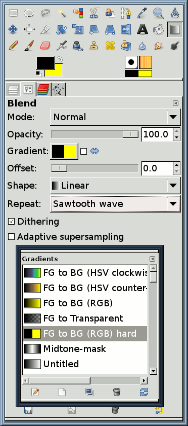

Another way is to use the Blend Tool with the Hard Edge gradient. Set the Shape to Linear, and Repeat to either Sawtooth or Triangle, then "paint" your stroke perpendicular to the direction of your stripes. The length of your stroke is either the width of your stripes (Triangle repeat) or half their width (Sawtooth). Hold down the CTRL key while you paint to make sure your stroke is at exactly a 45 degree angle.

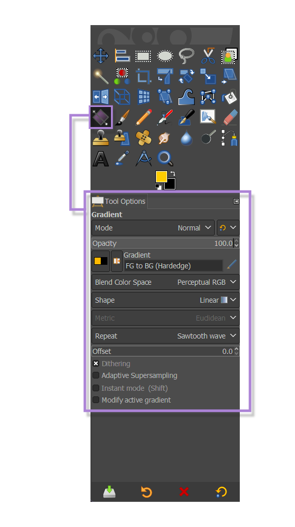

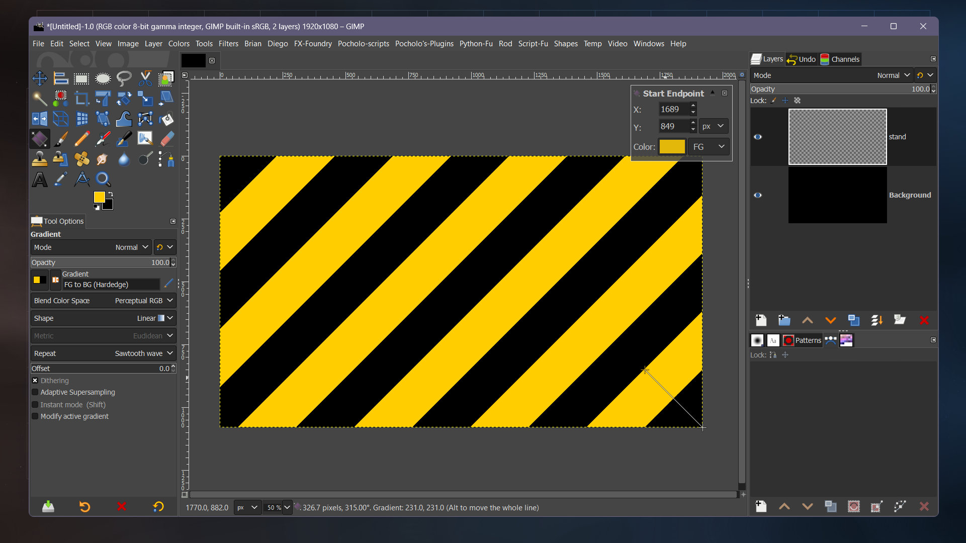

This is the hardedge gradient method for making a stripped pattern.
As originally described by saulgoode
View saulgoode's Post By Clicking Here.
Select a foreground and background colors.
In this case the colors are yellow and black respectively.
Within the gradients dialog.
Mode should be normal.
Set the shape to liner and set the repeat to sawtooth wave.
Stretch out the gradient form one side to the other.
Long stretch will give less strips, shorter gives more.
It's that simple!

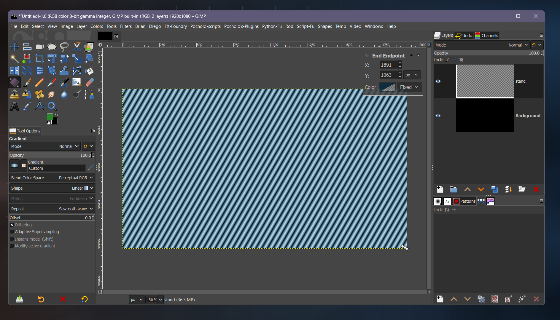

My plugin stripes does this
https://github.com/LinuxBeaver/GIMP-GEGL-PLUGIN_Stripes
 Post subject: Re: whats the best technique to make diagonal stripes ?
PostPosted: Tue Dec 17, 2024 5:13 pm  (#10)
Posts: 14281
contrast_ wrote:
How simple is it?
PostPosted: Tue Dec 17, 2024 5:26 pm  (#11)
Joined: Oct 31, 2020
Posts: 2025
contrast_ wrote:
How simple is it?

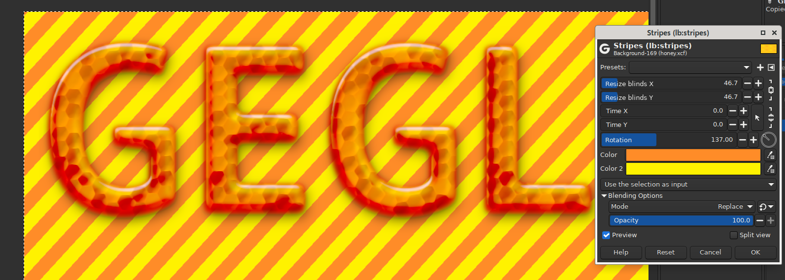

easy!
Go here, https://github.com/LinuxBeaver/GIMP-GEG ... s/releases
You put the binary (dll) in C:\Users\USERNAME\AppData\Local\gegl-0.4\plug-ins and restart GIMP. Go to GEGL Operation and look for "Stripes"
if on GIMP 3 you still have to put the binary in the location above, but you can just search "stripes" after running the plugin you'll see its simple.

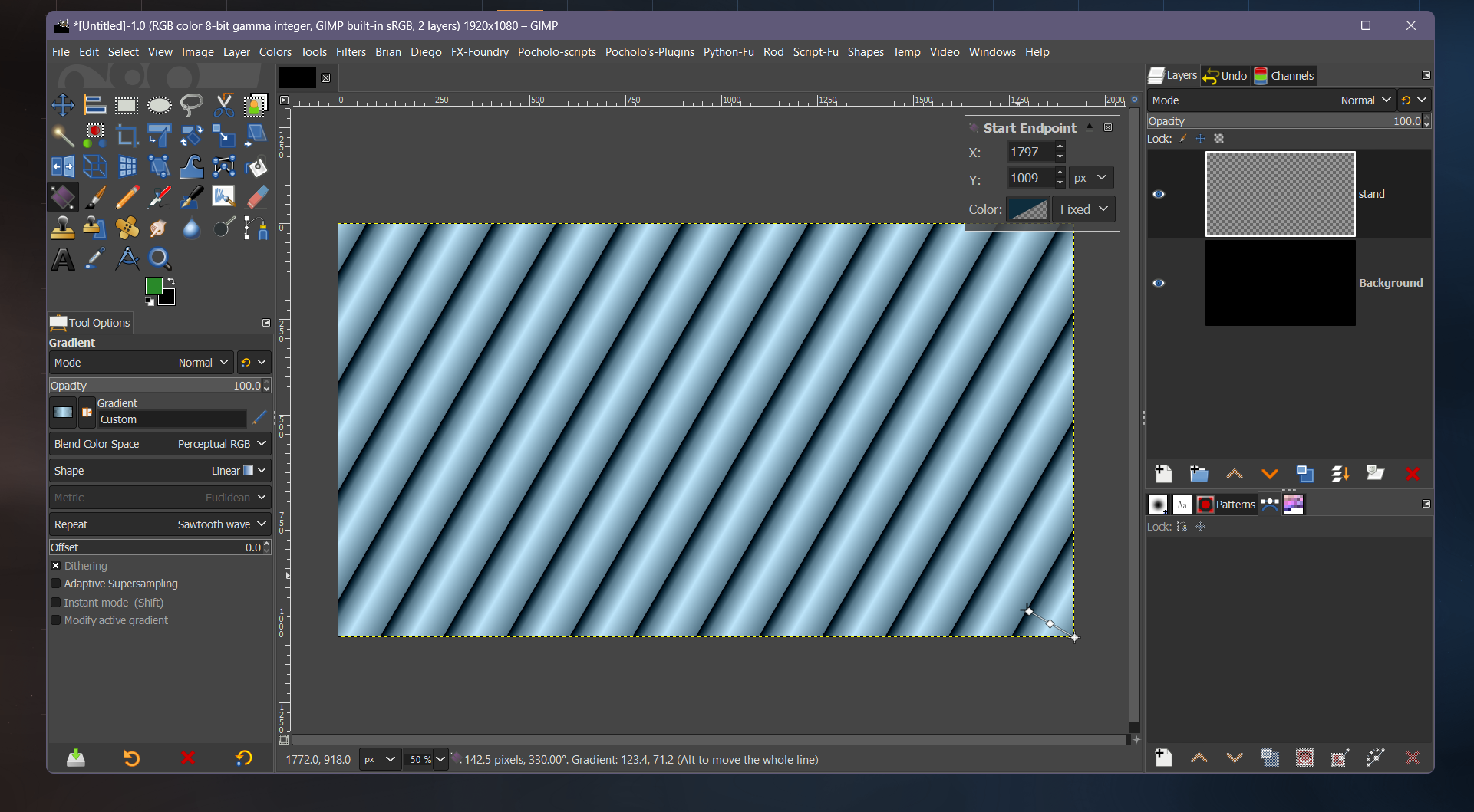

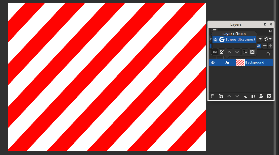

:lol The word "destructive" is a graphics design term. "destructive" means the same thing as raster. It can't be re-edited. Its applied as pixels only.
The plugin "stripes" can be edited again after applied on canvas in GIMP 3. Therefore it is termed "non-destructive"
Pic attached shows Stripes plugin as a "non-destructive" layer effect

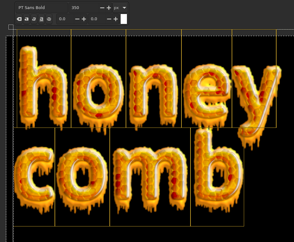

The text in GIMP 3 is called non-destructive graphical text because it isn't just pixels and can be re-edited.

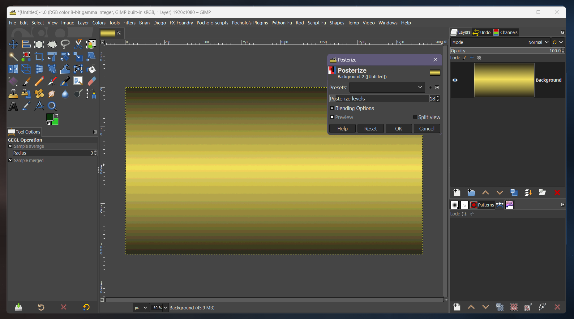

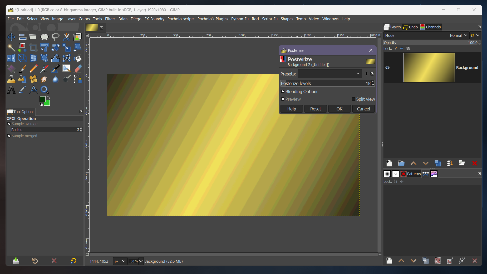

I get all that.
This method isn't anything new.
This thread has already demonstrated how easily this pattern can be achieved.
Another way right out of the box to make stripes with any gradient.
Would be to use "posterize".

cool I didn't know posterize could do that. Thanks for showing me
