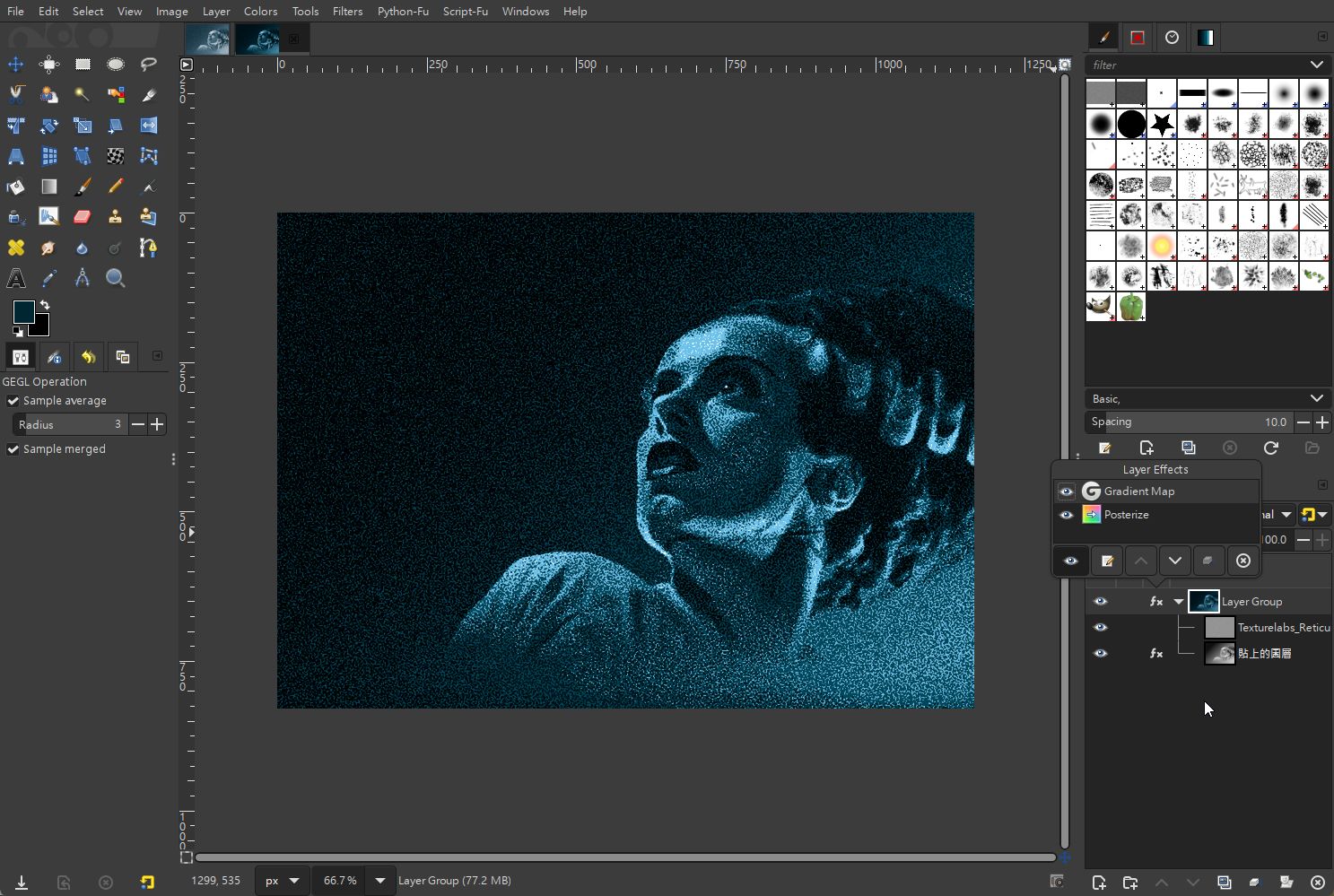

In this Photoshop tutorial
Photoshop Game-Changer! GRAIN SHADED GRADIENT MAPS
This was done with GIMP 2.10.38
It needs to merge the layers before applying the filter
But its final effect depends on some adjustments, so it may require frequent use UnDo.
So I tried using GIMP 3.0 instead.
But in the last step Gradient Map, I got this
It's so frustrating
Sorry for my poor English, I use Google Translate.
There may be something wrong, Please understand.

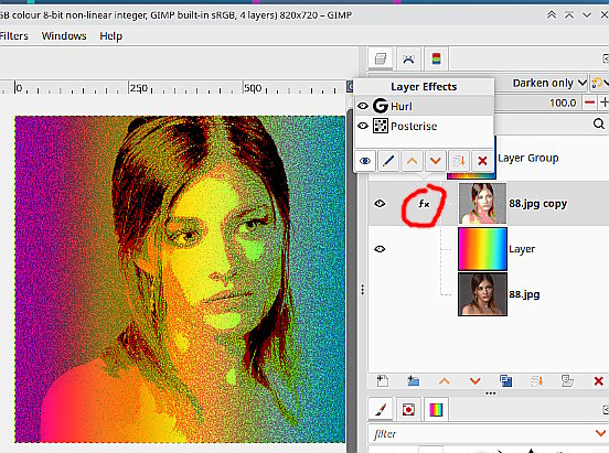

At the moment, NDE only supports GEGL filters. Gradient Map is a "legacy" plugin. You can see it better in Gimp 2.10 where the GEGL filters have a G against the menu entry. The G has been dropped in GIMP 3.0
Edit: Sorry I do not watch YT videos anymore, too many advertisements.
You will just have to find other ways: Here two NDE filters that are still editable + a gradient but that relies on a Layer Mode.
Thank you for your reminder
I find Gradient Map in GEGL operation
And I use Firefox+AdBlock to watch YT videos, it block any advertisements
GIMP 2.10.38 rev1 portable+GAP+G'MIC+nufraw+Beautify+MathMap+...
