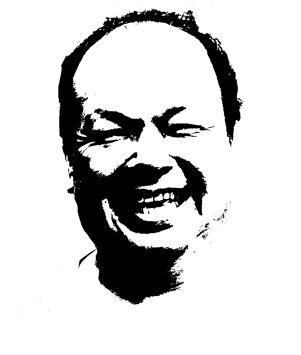

If you need to convert your image to true b/w (not grayscale), there is two built in ways in GIMP to do so. You can either go to the color menu and chose threshold (I did this straight with no enhancements; not really that great of result; could enhance before doing so to get better result):

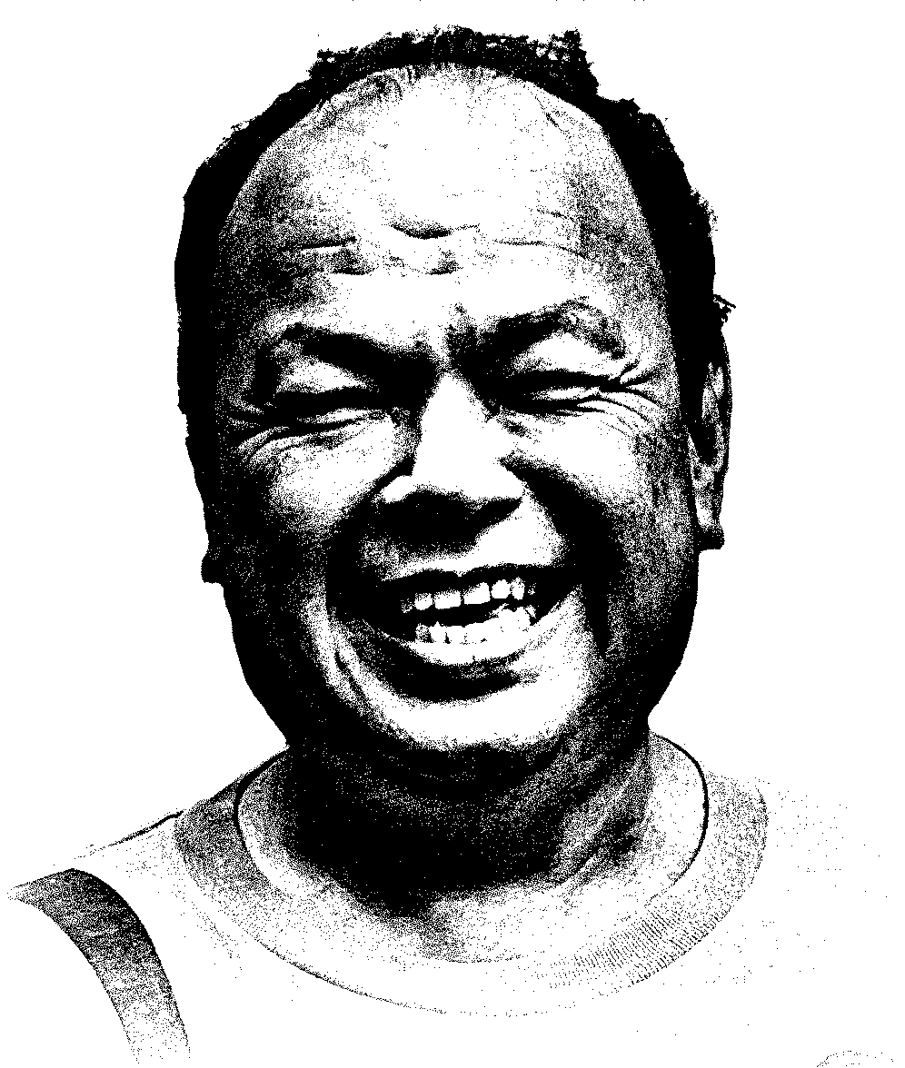

Choose GEGL Color to Grey followed by dither and then threshold:

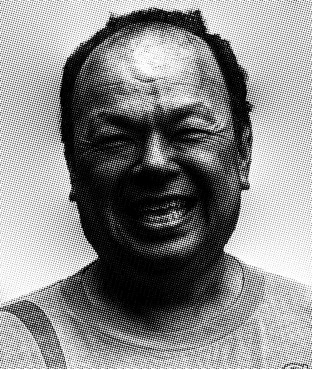

Did some enhancements then used GIMP's Newsprint:
colortogreay_dither_threshold

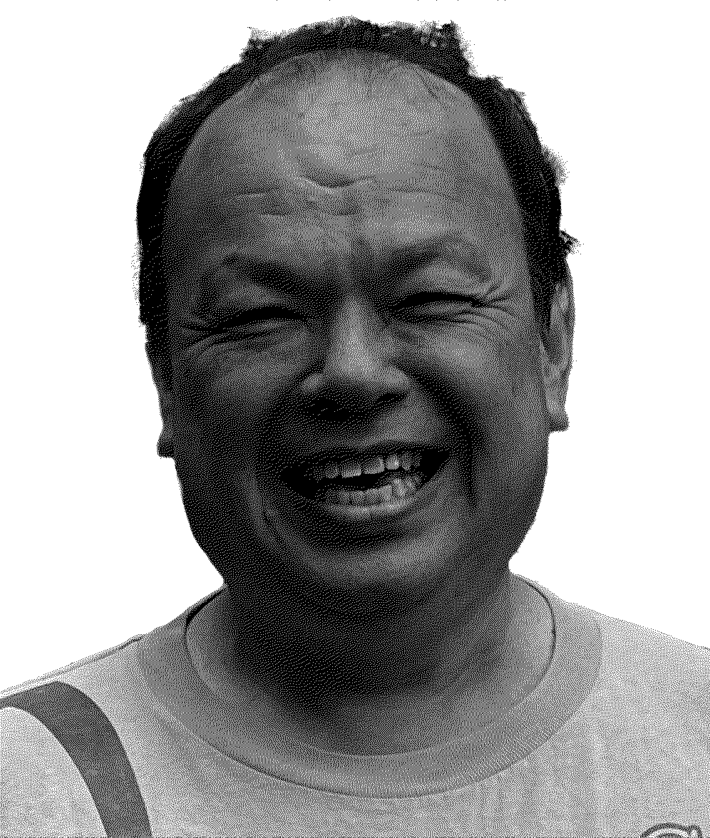

Now, if you are willing do use plugins outside of GIMP, you can give GMIC a whirl. there's several ways, but I'm only sharing dither. :)

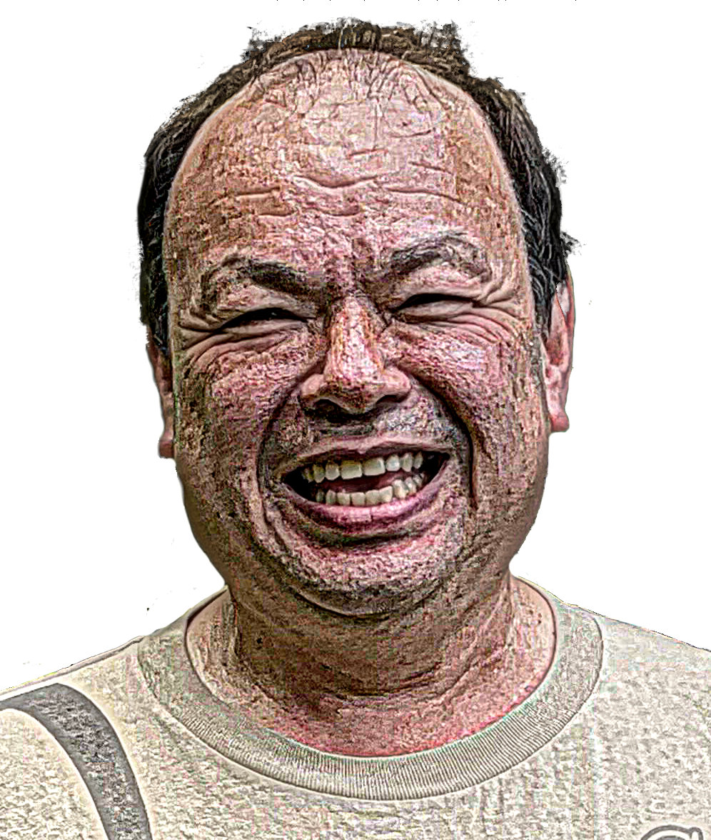

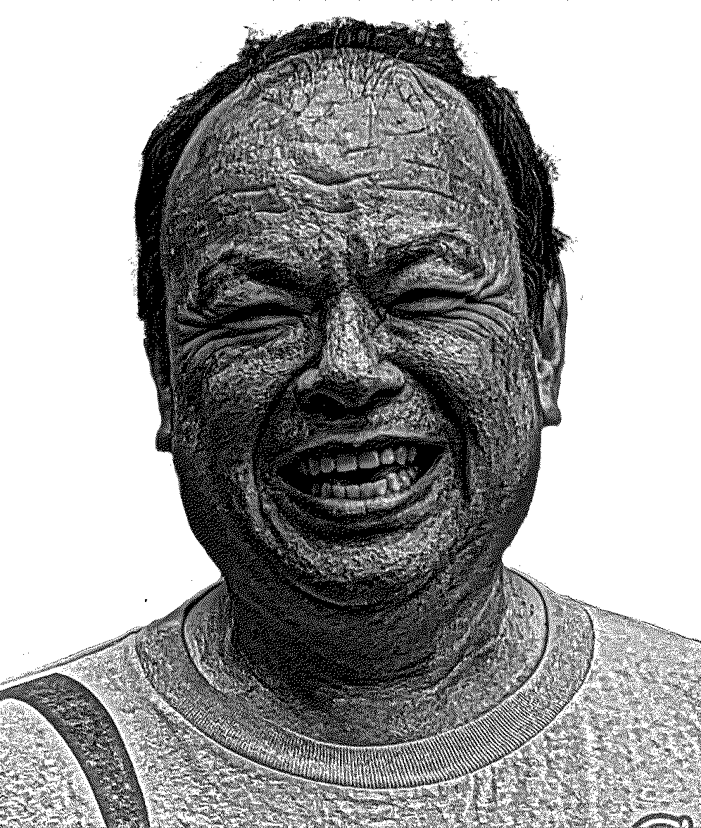

OK; should have read your reply better. For G'MIC, again, way too many ways to enhance image prior to binaraizing if you will. Would recommend local variance normalization (under details) to give your image gritty contrast. You can then easily do dither afterwards for even stamp to get true binary b/w. :)
followed by dither:
