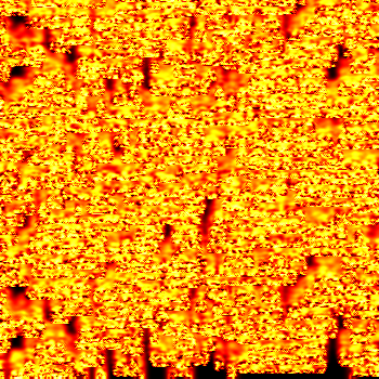

I wonder if G'MIC sequencing could be used for this?
 Post subject: Re: Particles in Gimp?
PostPosted: Wed Jun 12, 2013 12:58 pm  (#19)
Posts: 16201
Here is an example using sequencing-edges on fire.
APNG
GIF
